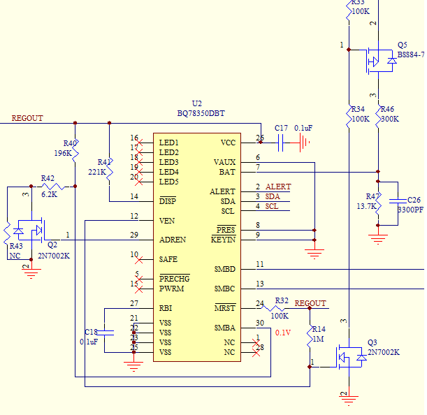

Helllo,
     I have made a 6S demo of bq76930 and bq7850,Now I have tested some basic functions including communication is normal.
But I've found that BAT  and VEN have always been low level, I want to know under what conditions will they be high level? Or I have an error in the circuit diagram below about bq78350-r1?
2、I want  to change the default address,but i find the ADREN is always low level,so i reserve R43. At the same time, I wonder why ADREN is always low level? If don't have ADREN, it's also  to change the address. So what does ADREN do?
Thank you!
