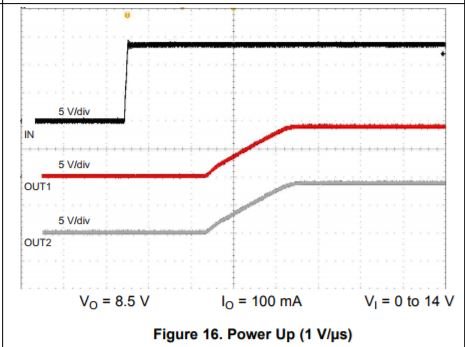

I don't find one exact timing description of soft start about TPS7B7701/02-Q1.
It should have soft start function of this part, right, though it's fixed in the chip ?
Could you help double check the timing in design?
Thanks.
  • Hi Rocson,
    This device has the soft start function built in. We have two plots showing the startup behaviors of the device. Please see Figure 16, 17.
    Jason
  • Hi Jason,
    Thanks for your reply.
    I noticed this waveform plots without timing, and that's why I quite sure that there must be fixed timing soft start for this chip.
    But customer would like to know about the exact timing setting during our IC design.
    Thanks.
  • Hi Rocson,
    The datasheet does not have a specification for the startup time. Figure 16 and 17 provide application curves for reference purposes. As the figures indicated 1V/us, we can estimate each division is 100us; the rising time for the Vout from 0% to 100% on both plots is around 200us.
