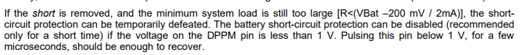

In my application, I intend to set RDDP to its minimum value, as I do not need DPPM or short circuit protection. Is there a valid reason for not simplifying my circuit by simply grounding the DPPM pad?
