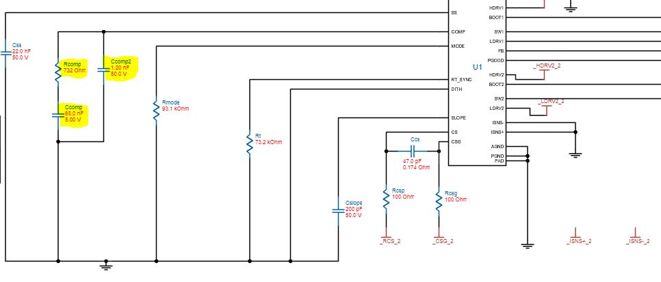

I'm designing power supply but I need a advise for main IC.
Vin could be 24V
Vout is 2V to 30V and current is 1A
Output should be adjustable, I can adjust with potentiometer, I found LM5175 but Webench tool does not support it.
Thanks, Ali.

  • Hi Garret,
    Thank you for your reply. I designed 2 difference schematic with LM5175. My question is when I change the feedback resistor value, Rcomp and Ccomp and inductor values are also changing. I attached the screenshoots.
    This one Vin= 24 Vout=2V @ 1A
    This one is Vin = 24V Vout = 30V @ 1A
    I would like to use just potentiometer for adjusting the voltage. I need a help for fixing this values.
    Thanks, Ali.
  • Hi Ali,
    You should set the compensation around the worst case conditions. This is going to be the maximum boost condition, which appears to be VIN =24V -> VOUT=30V@1A. Calculate the compensation values (RCOMP, CCOMP, CHF, Top RFB) and then use these for all the other conditions. Simply change the bottom feedback resistor to modify the output voltage.
