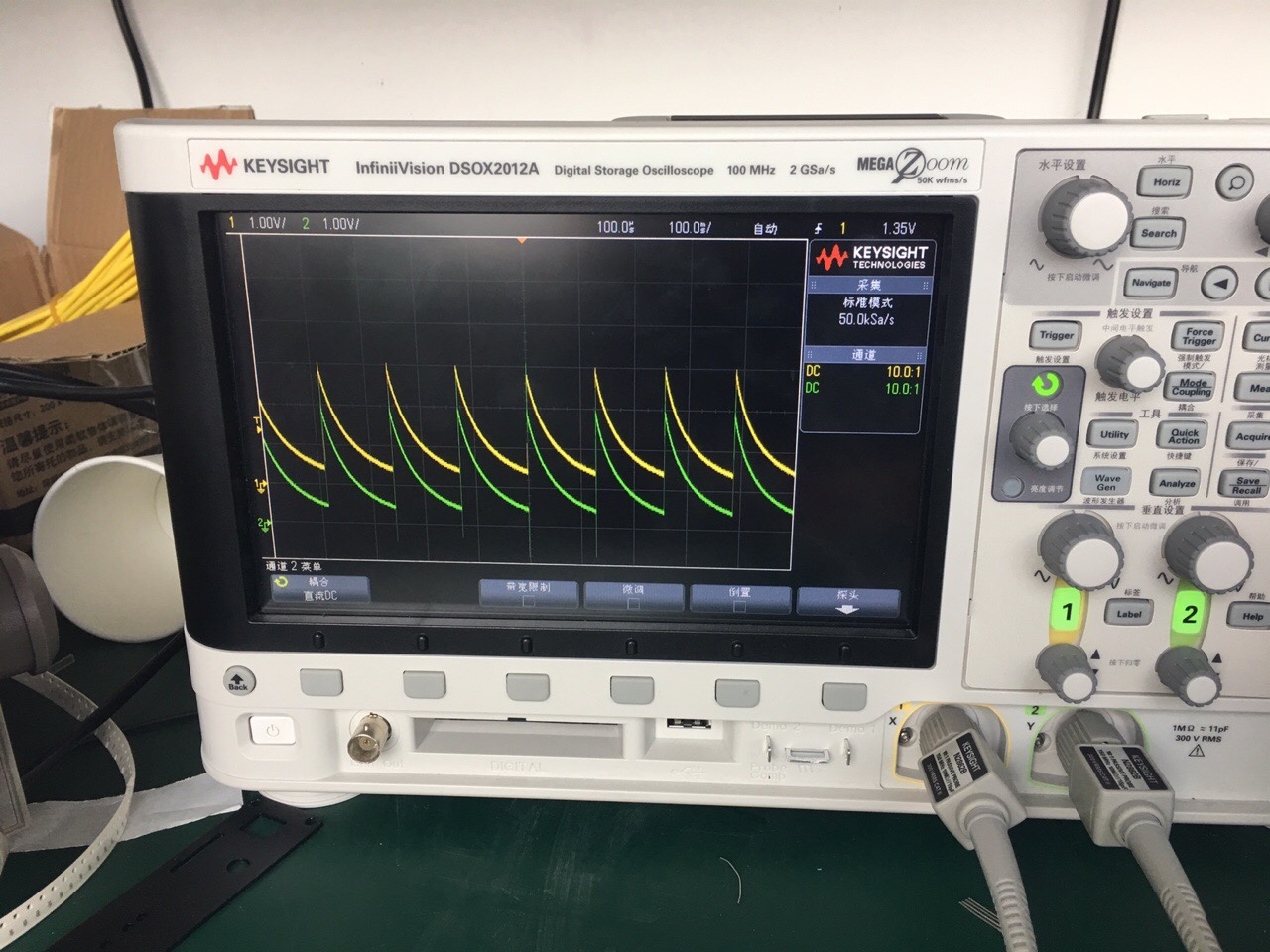

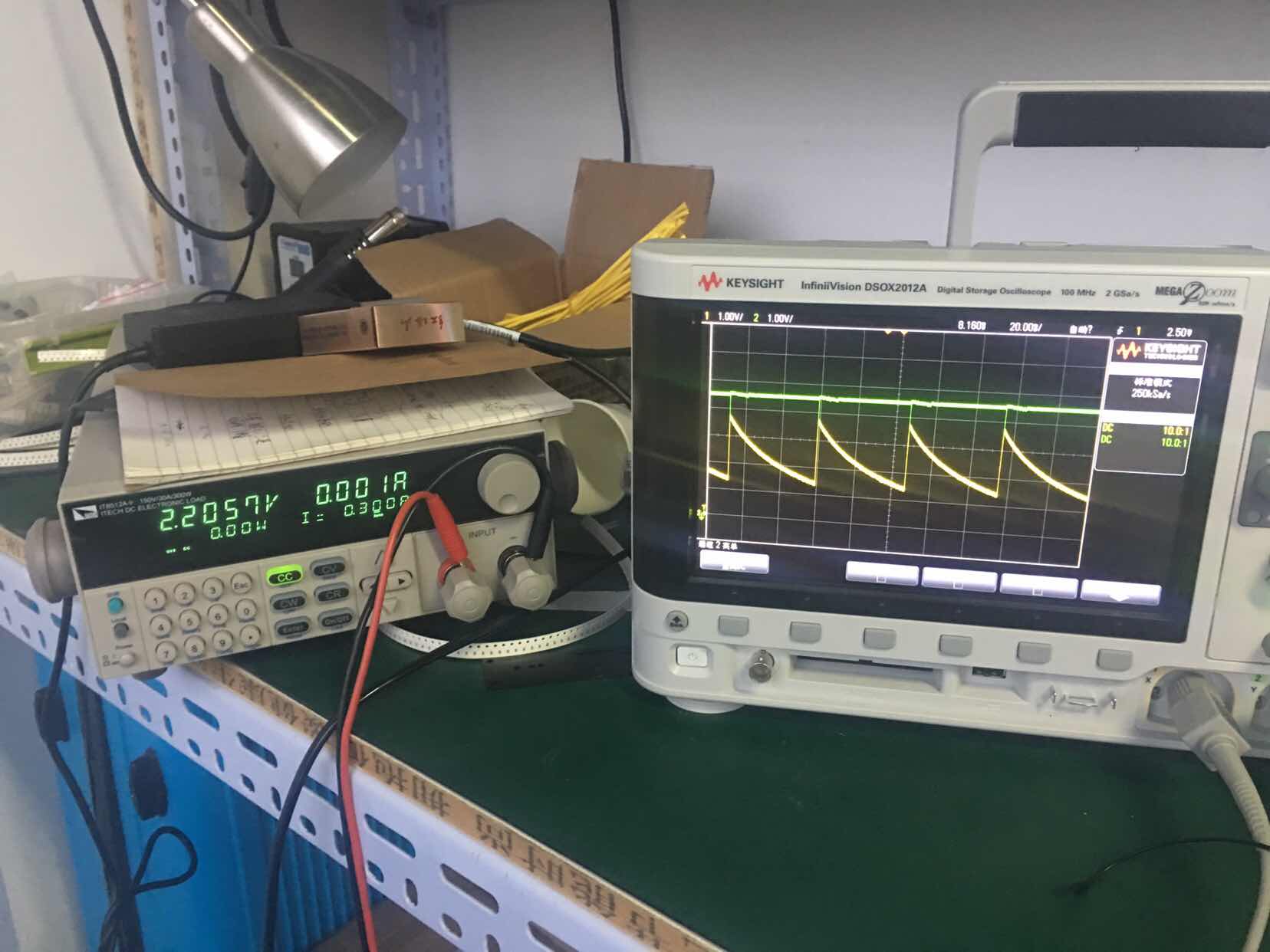

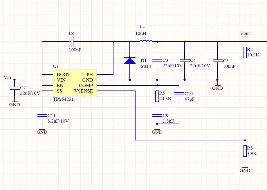

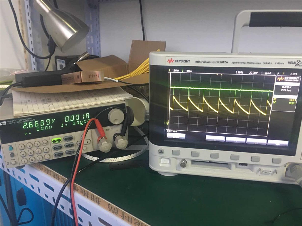

Working conditions:
Vin Max 28V
Vin Min 3.5V
Vout 3.0V
Iout Max 1.0A
Iout Min 5uA(msp430 in Shutdown mode)
when Vin = 3.5V, Iout = 5uA,
TPS54231 Vout is only 0.8V,it is should be 3.0V.

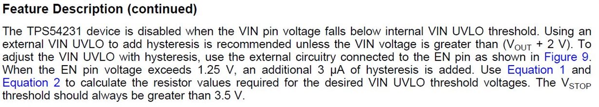

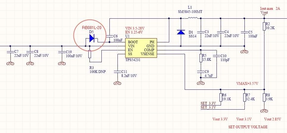

I have changed many parameters in the Schematic, unfortunately, the Vout is still 0.8V. By searching in the forums, I found that many people and I encountered the same problem. Many people think that is due to Eco-mode caused the problem.
Would you please according to my needs, to help recommend a new DCDC?
