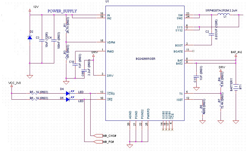

DPM resistors are 26.7k and 10k, as on the data sheet
- resistor on ISET is 400ohm
- IN voltage is at 12 V
- SYS voltage is about 4.2-4.3 V
i am not using usb pins usb1,usb2,usb3, ce#
Hey naveen,
The voltage divider at the TS pin puts that pin at ~69%*VDRV, which is well outside the TCOLD range. The charger will not charge if outside of TCOLD. Consider changing R7 to a lower value to give you something around 50%.
Let us know if this solves your issue.
Joel H
