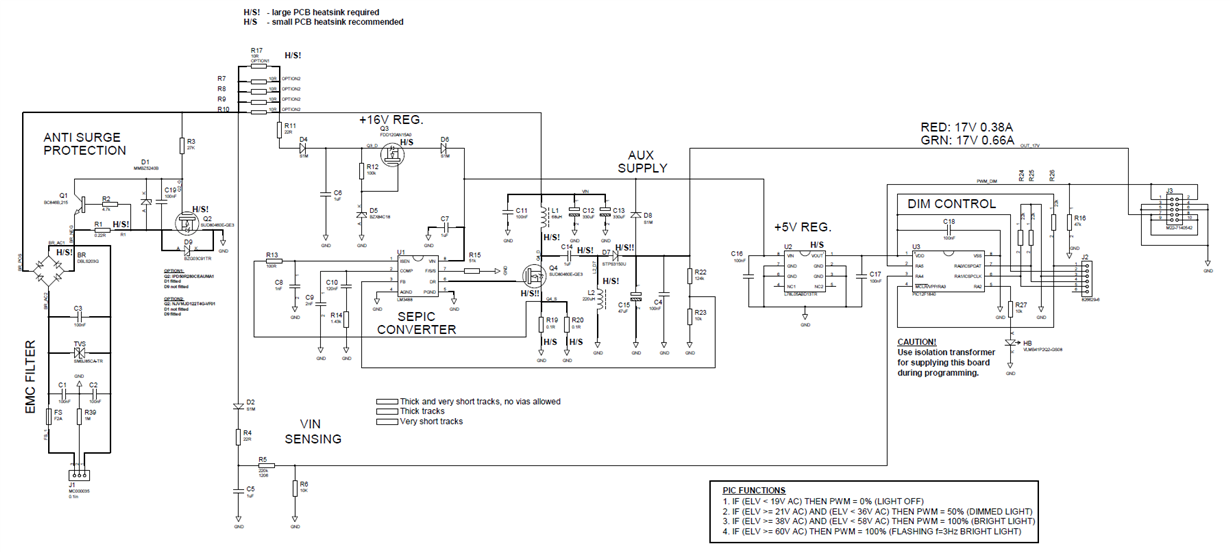

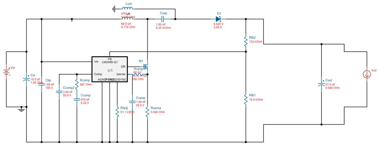

I have measured efficiency of the whole driver I built (with R17=0R). The max efficiency is 82%. Comparing to WEBENCH results it is about 10% lower. Provided the input voltage is higher comparing to WEBENCH design (where Vin max = 40V), is there any chance to obtain better efficiency?

Fig 1
Fig 2 WEBENCH diagram
Fig 3 WEBENCH efficiency chart

  • How did you measure the efficiency? Have you included the power taken by the dimming control circuit as well as other additional circuits that are extra to the Webench model?
  • Yes, you are right. I should have isolated the converter first then measure the efficiency.
    However, the currents of different parts of the whole circuit are as follows:
    - dimming control <4mA
    - 5V reg. 6mA
    - LM3488 3mA
    So, the power loss in those components should be: P = 17.6V x (4+6+3)mA = 0.23W,
    where 17.6V is the output voltage of the converter.
    I doubt that 0.23W taken by those components changes the efficiency significantly.
