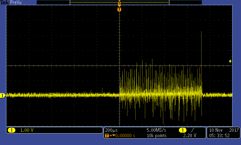

I use the latest  EM1402 reference design to design battery management system. When send 0x10, the fault code read from emb1428 is 0xA1,when send 0x00,the fault code read from emb1428 is 0x10,And it indicated that there were "Pimary Side Current Limit "fault .When use oscilloscope,I can see there is peak in Sense Resistor.
