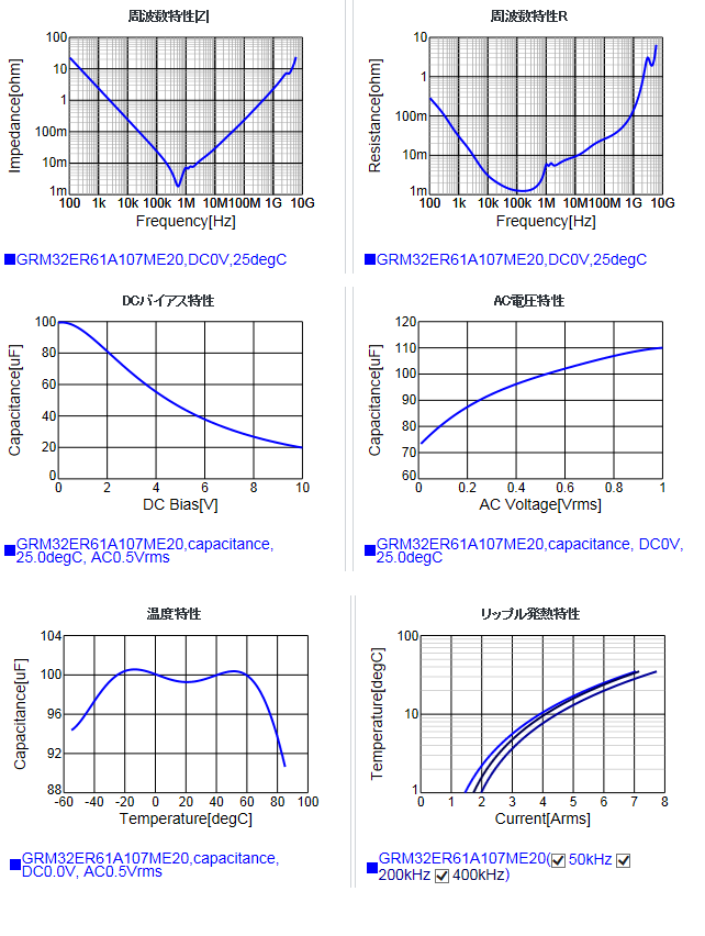

I was taught about ceramic capacitors with the following thread.
Based on that advice I am considering using the following parts for the output capacitor now.
Is resistance and capacitor selected by me OK?
It will be appreciated if you advise concerns.
(Selected parts)
Low resistance: SR732ATTDR100F / KOA
Ceramic capacitor: GRM32ER61A107ME20 / Murata
* Characteristics of the ceramic capacitor are shown below.
e2e.ti.com/.../637320
