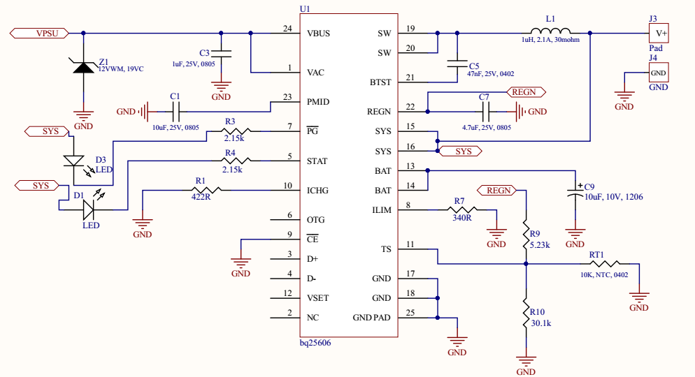

BQ25606: Single-cell Charger Design without PPM
Part Number: BQ25606
I designed a charger for a single-cell battery. I used bq25606. My concern is I am not using its USB or power path management features. The circuit that I designed is given below. Can you evalute this schematic, with my given concerns?
Also I have some concerns about charge termination. Charge termination current is not programmed in this circuit. How does it end the charge?
Should I connect SYS pins to the output or should I just use it as LED supply?
Configuration: Input: 7.5V, ~1A Charge: 4.2V, 1.25A
