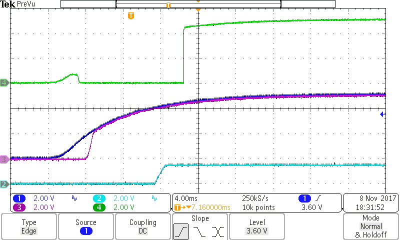

    Thanks for reply. And I did a experiment use our tps54394 EVM, just as you say, I connect PG to Vin with 100k resistor. Get the below waveform.
    1: Vin; 2:Vout2; 3:VREG; 4:PG2.
    PG2 is a small spike, so could you tell me why their is a spike? And if I change the pull up resistor, the spike could be higher? For if customer wants to use PG to achieve power-on sequence control, the spike level must be considered.

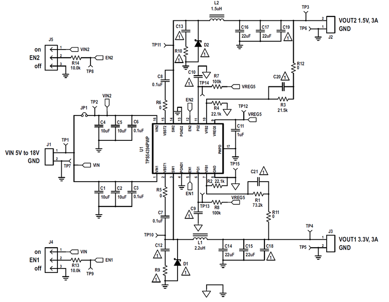

  • Pls upload your schematic.

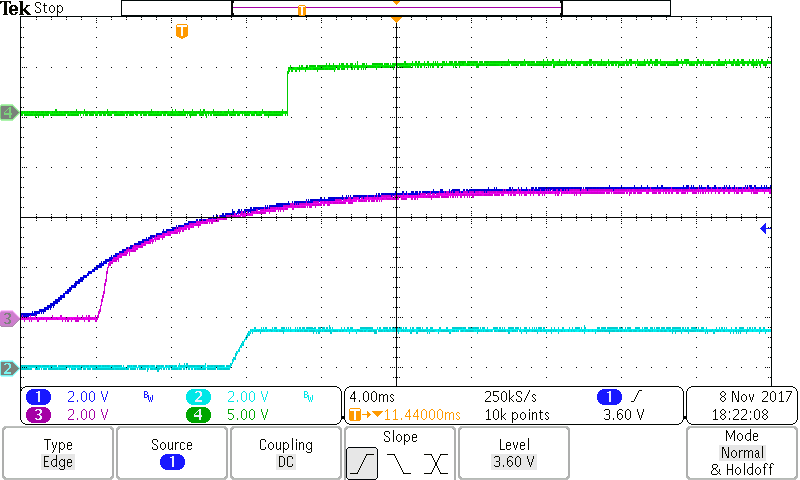

    Try connect the PG1 to the VREG and Vout to the waveform. Is there still have the spike?
  • I use the EVM for test, and PG1 is connected to VREG. There is no spike.
    However the customer connect PG1 to Vin, and max Vin is 5.5V. So there is a spike in PG1. They want to know why there is a spike? And if the pull up resistor will influence the spike amplitude.
  • HI Will,
    Before Vin higher than around UVLO, the device is not wake up and internal power is not ready. The PG FET will be high impedance so you will see the spike. On contrary, If PG is pulled up to VREG5 or Vout, the spike is not there since the device will not have Vout or VREG5 before UVLO. The spike amplitude will depend on Vin amplitude before UVLO. Hope it will answer your question.
