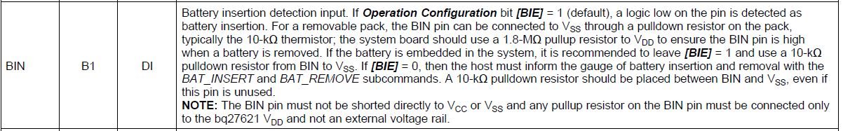

There is informed system board should use a 1.8Mohm pull up resistor to Vdd.
But pull up resistor is 4.7Mohm on EVM schemetic.
This value is not important?
