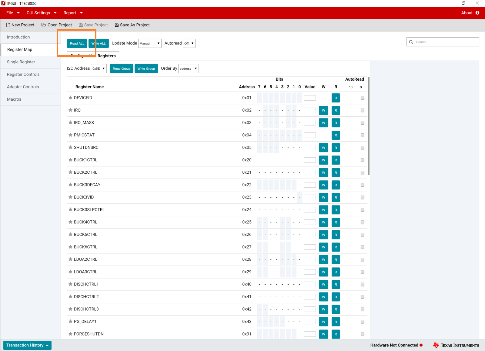

  • The best place to see what the initial code is for the device is to look at the datasheet in section 6.7 "Register Map". This shows what all of the registers should be set to as soon as you turn on the device.
    www.ti.com/.../tps65094.pdf
    You can also connect to the PMIC and click the "Read All" button in IPG-UI and then go to Report>Dump Registers to create a file with all of your register contents. This would help us see what the PMIC is reporting after the issue occurs.

    I also put these registers into a project file so you can open this project, and then click "write all" to set all of your device's registers to the default values.
    https://e2e.ti.com/cfs-file/__key/communityserver-discussions-components-files/196/E2E.json
    To send us a file with your register dump you can follow the pictures below.
    Thank you,
    Nick

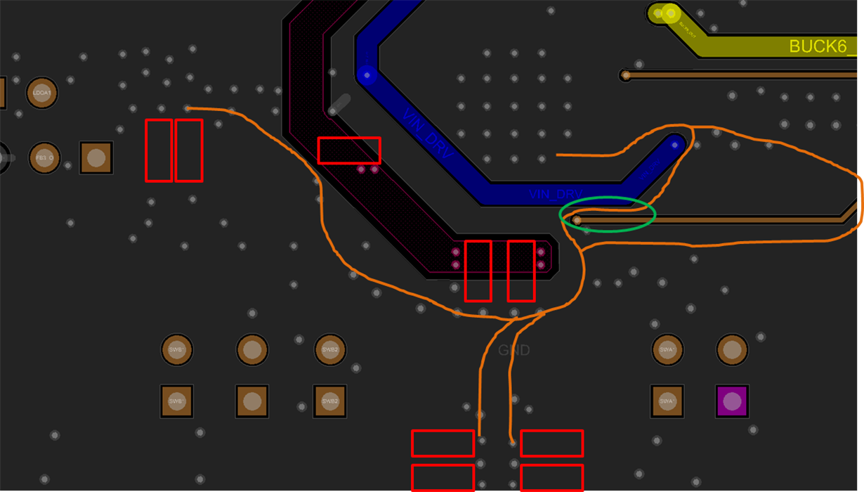

    Thank you for the board file, it is much easier to navigate than the PDF and makes it more clear. I have not seen someone do a 2 layer board design with this part; in looking it over I am a bit concerned regarding the parasitic impedance on the GND return path for all 3 BUCK converters. In particular, all three of the converters are going to end up funneling into a small area between the DRV input and FBVOUT1 or around the other edge of FBVOUT1. See the image below.
    Can you check the switch node in a scope shot? I am concerned with how high the ringing might go. With the added impedance, it may be ringing higher than expected. Note that this will require a high bandwidth scope to be able to see.
    Finally, I would still recommend switching to the TPS65086 or TPS650864 family; they provide better catalog control than the TPS65094 family. With the TPS65094, if the part has a power fault after you change the default voltage settings then the voltage will power-up again to the pre-programmed value because PMICEN is high. For the TPS65086 or TPS650864 family, the CTLx pins can all be set to GND and a power fault will just cause all rails to turn off.
    There is a good article regarding the impacts of parasitic impedance here:
    Note: highlighted red boxes are the input and output capacitors located on the other side of the board.
