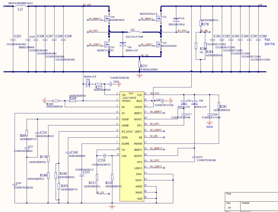

    我遇到的问题分两种电路来描述
一:TI推荐电路,参考webbench。输入电压16V~40V,输出21V/7A电路。
      1:输入16V,输出21V,输出电流加大到6.4A时,LM5175会损坏。如附件图16V输入,21V6.4A输出的各位置波形。
      2:输出21V/3.5A,输入电压从16V加大到19V时,LM5175会损坏。如附件图19V输入,21V3.5A输出的各位置波形。
由于在第一种状态内发现,在6.4A负载时,左边上管和下官驱动有变化。为了排除问题,故先看boost状态是否正常。所以有了第二种情况:
二:(TI推荐电路,参考webbench输入电压16V~40V,输出21V/7A电路)这个电路的基础上,并把左上管DS短接、左下管取掉。图形见对应附件

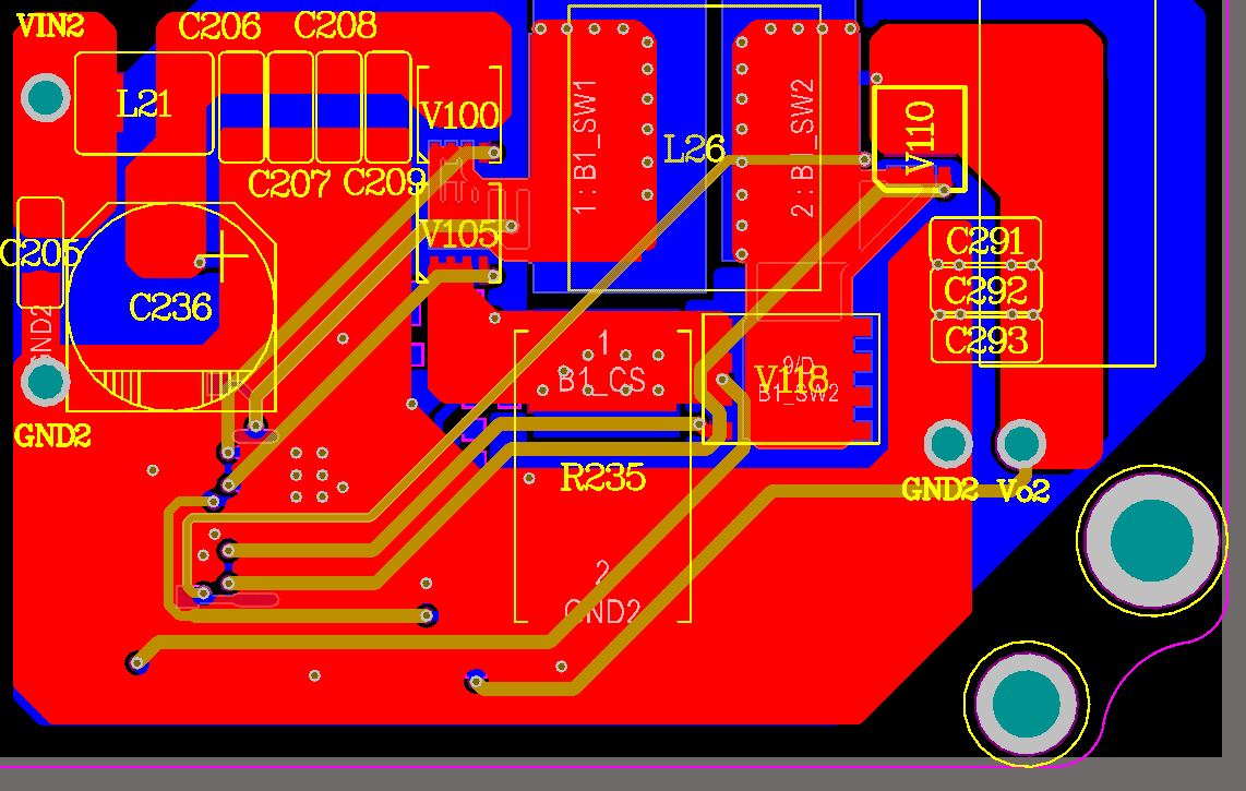

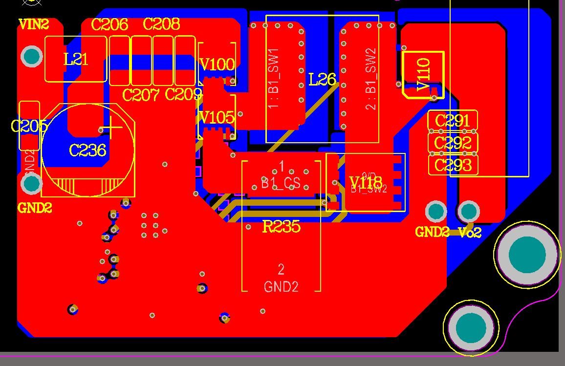

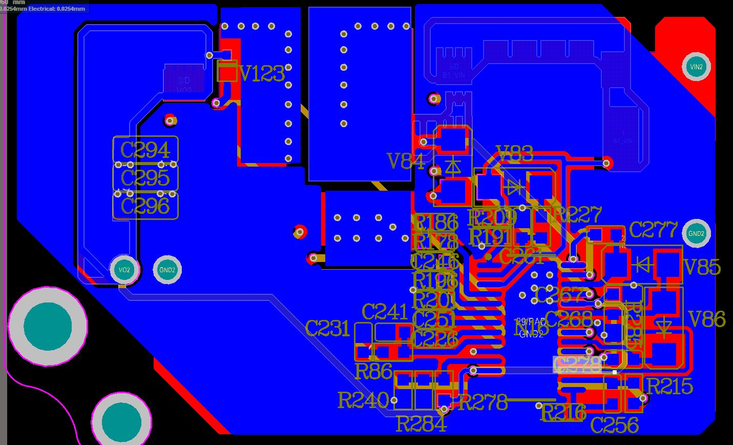

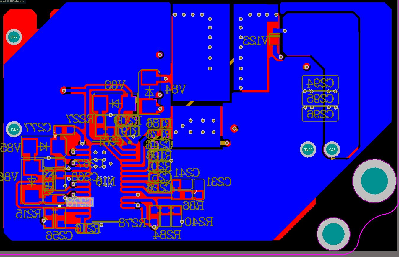

顶层:
中间层:

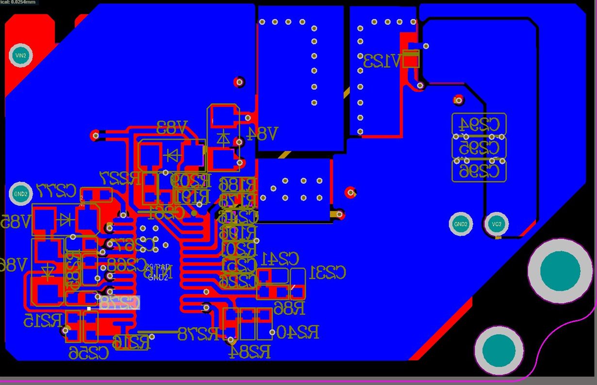

底层:
底层-镜像:

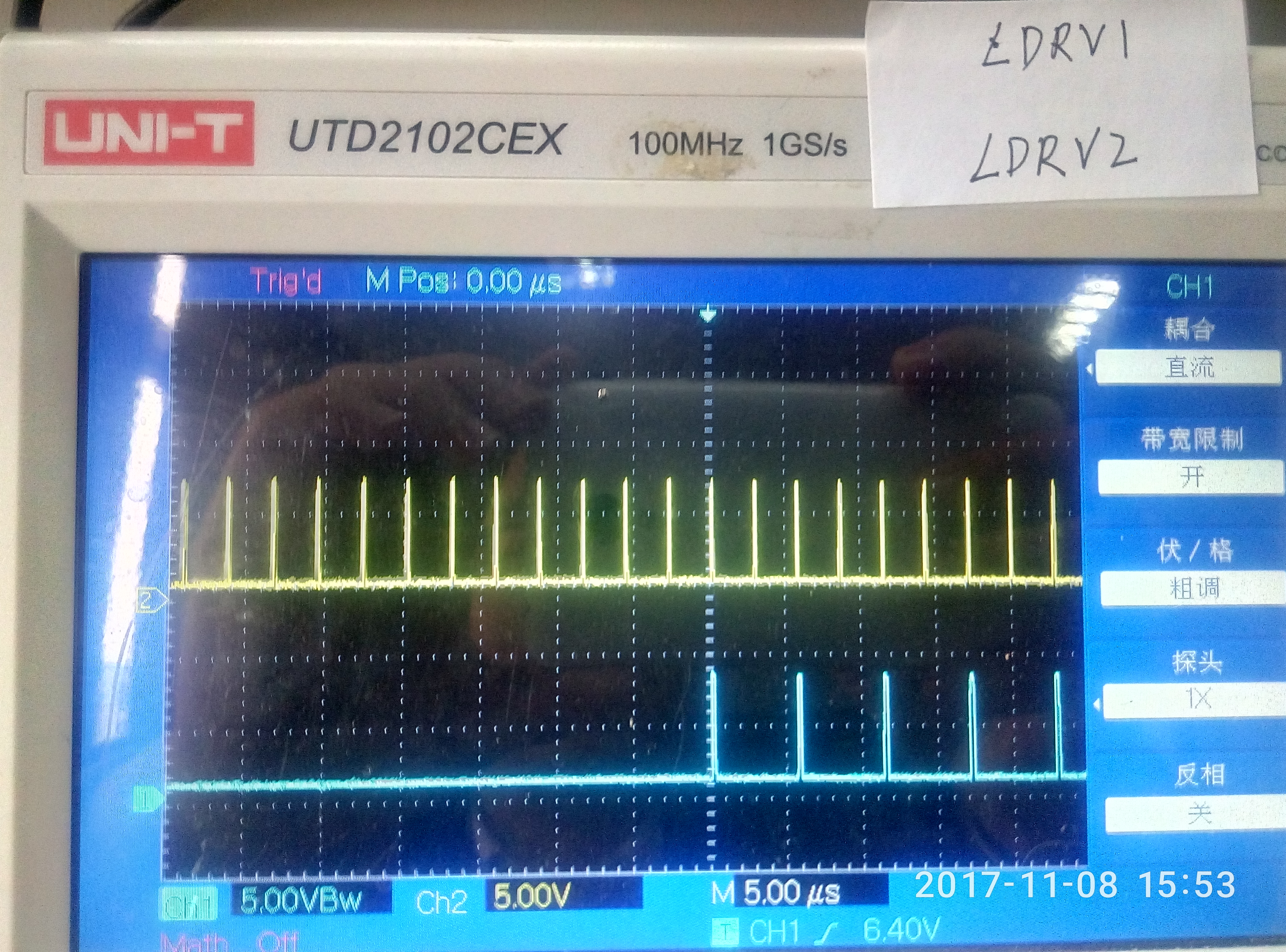

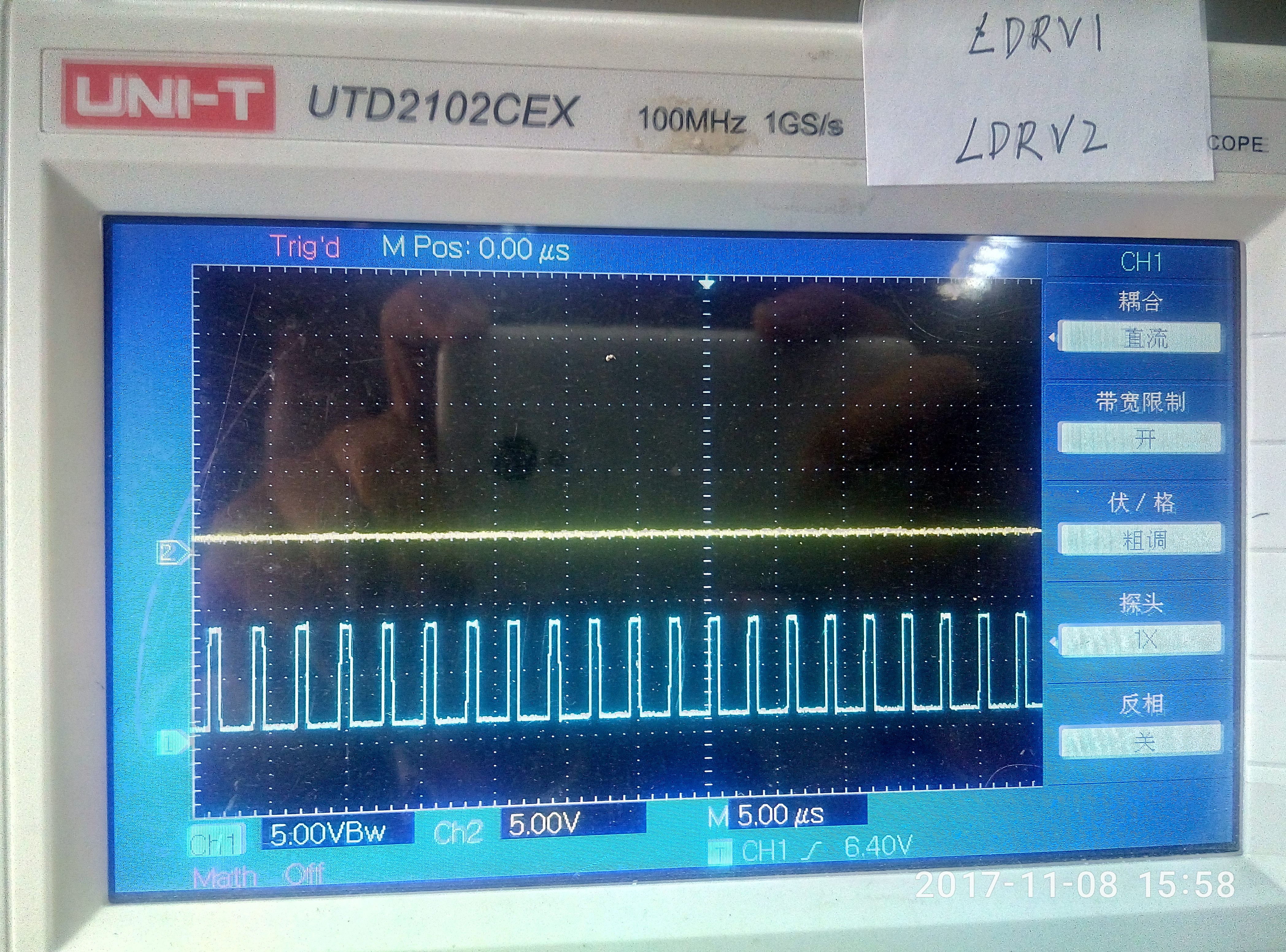

第二电路:输入16V输出21V1A负载黄色(20倍衰减)为HDRV1蓝色为LDRV1:

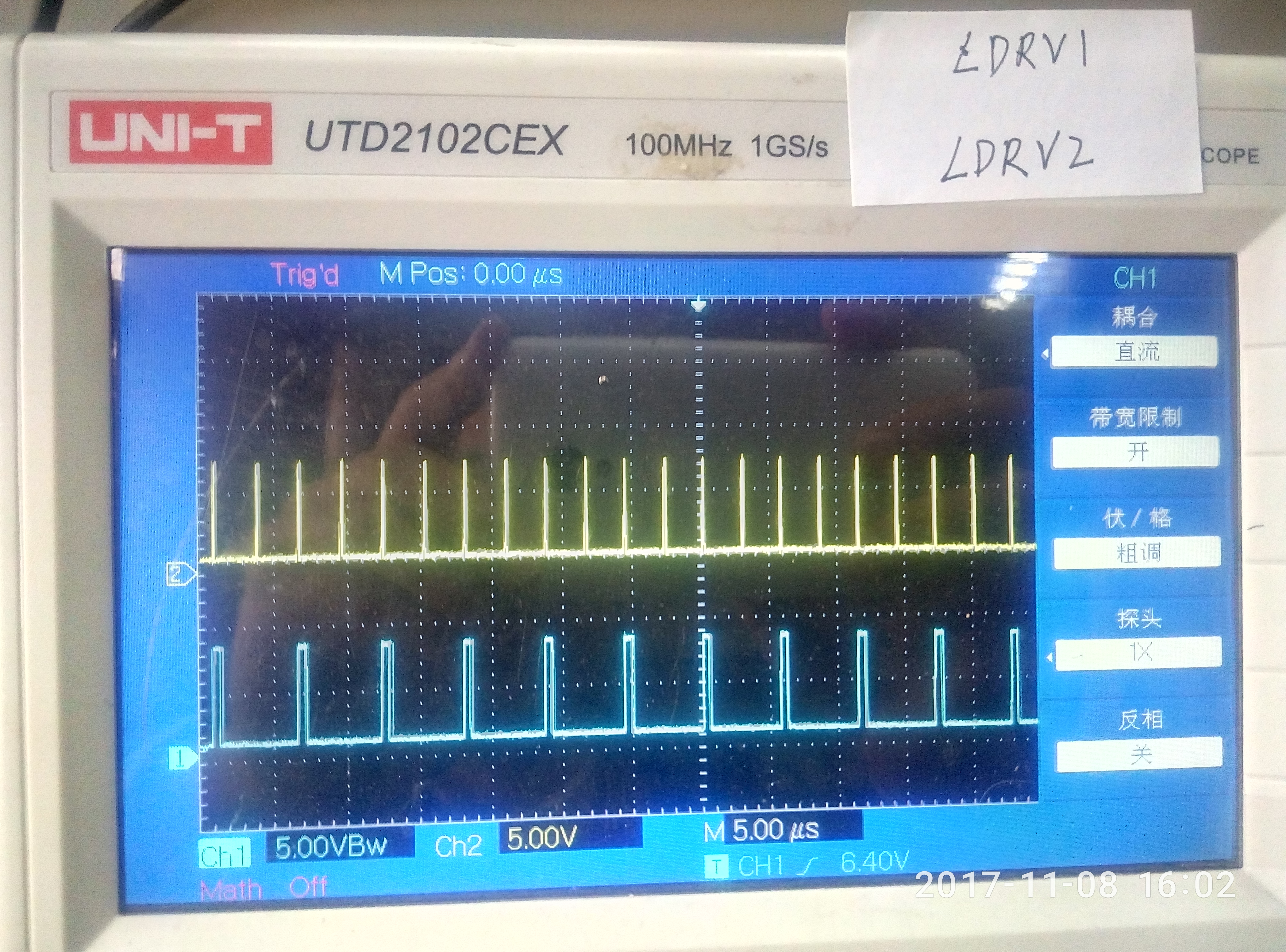

第二电路:输入16V输出21V1A负载黄色为LDRV1蓝色为LDRV2
第二电路:输入16V输出21V空载黄色(20倍衰减)为HDRV1蓝色为LDRV1
第二电路:输入16V输出21V空载黄色为LDRV1蓝色为LDRV2
第二电路:输入19V输出21V1A负载黄色(20倍衰减)为HDRV1蓝色为LDRV1
第二电路:输入19V输出21V1A负载黄色为LDRV1蓝色为LDRV2

  • Sorry for the delay. I reviewed your schematic and the layout, and found you did not follow our layout guidelines presented in the datasheet. For instance, the gate drive trace for the right high side FET and the return trace are not placed closely side by side but they are separated widely over the switch node. This will affect the drive performance .
    The LDRV1 and LDRV2 should never give driving pulse at the same time. It is really weird to see it on your circuit, and it seems the IC is damaged somehow. Did you replace the IC and see it if still showing the overlapping drive signals?
    At 19Vin and 21Vout, the IC may be in the Buck-Boost Transition mode, namely both buck and boost leg will be switched alternatively. But it should not look like what you show here.
    As you may know, we recently released the LM5176, which is almost pin-to-pin compatible with the LM5175: you just need to change the RT resistor to keep the same switching frequency. The LM5176 can be seen as an improved version of the Lm5175, with greater noise immunity. Replacing the LM5175 with the LM5176 on your existing board may resolve many issues you are currently seeing.

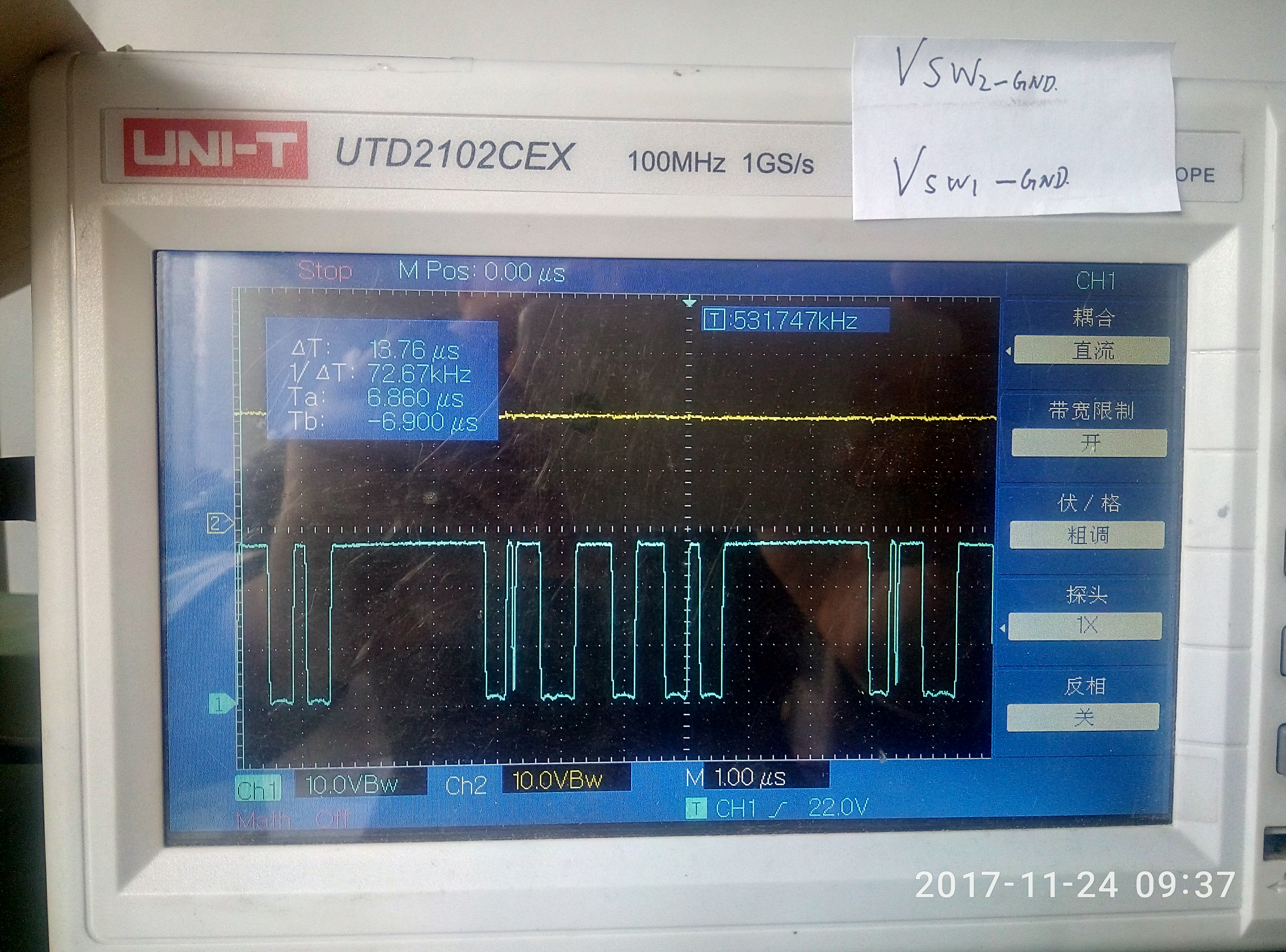

    但是我还是有一点问题:
    输入超过28V时,输出电流最大到4.9A能稳定工作,但是超过5A,就会出现不稳定。
    波形如下:
    黄色为SW2对GND波形,蓝色为SW1对GND波形。
    输入超过28V后,都有这个状况。
    请帮我分析一下,谢谢。

  • Again, sorry for the delay owing to being out of office during the Thanksgiving holidays.
    The SW1 should continue to switch in the buck mode. However, your waveform shows it intermittently stops switching.
    There are a few possibilities to cause such abnormal switching behavior.  Have you monitored SW2?  And the input voltage and see if it fluctuates when such abnormal behavior occurs? Could you take a scope picture showing Vin, Vout, SW1 and SW2?
