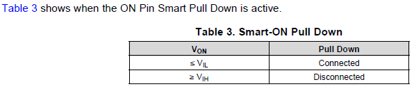

TPS22916: (TPS22916CL) - Smart-ON Pull Down feature behavior for Active Low version
Part Number: TPS22916
In the TPS22916 datasheet, the Smart-ON Pull Down functionality seems to be written with respect to the Active High devices only. Per Table 3, if the Smart-ON Pull Down was connected with VON <= VIL, then it would be active during normal operation, opposite of the behavior for the Active High versions.
So for TPS22916CL, is the Smart-ON actually a Pull-Up and the reverse of Table 3, to keep the load switch off on power-up until the Active Low signal is asserted?
Jonathan
