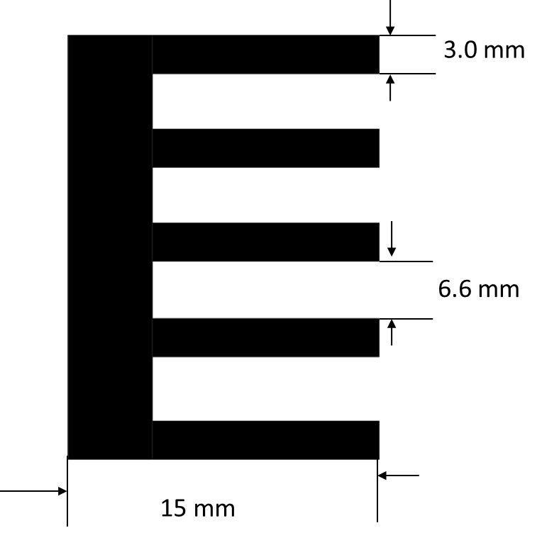

I want to built and evaluate the reference design TIDA 01494 does anyone know which heatsinks are used or a similar sample that can be used?

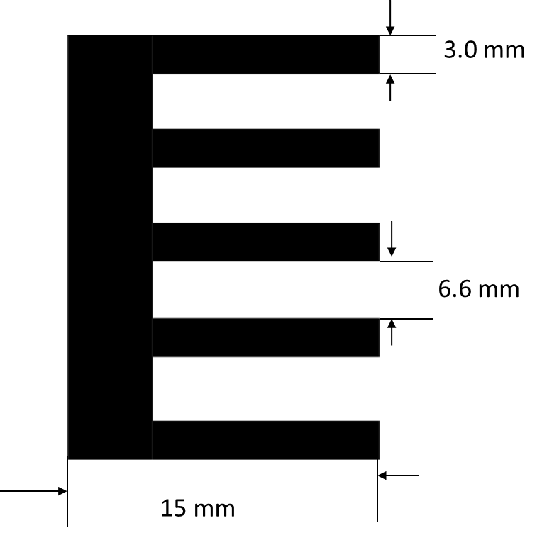

Are the any news about the heatsink?
I cant even find the transformer T1 (750343657R Wurth Elektronik). Is there a detailed specification or an other reference number?
Hi Michael.
I have attached the spec sheet for the transformer. As for the heatsinks, they are custom built from extruded heatsinks, inside our lab. I will try to send you a document with the exact dimensions in a couple of days.750343657,Rev01.pdf
