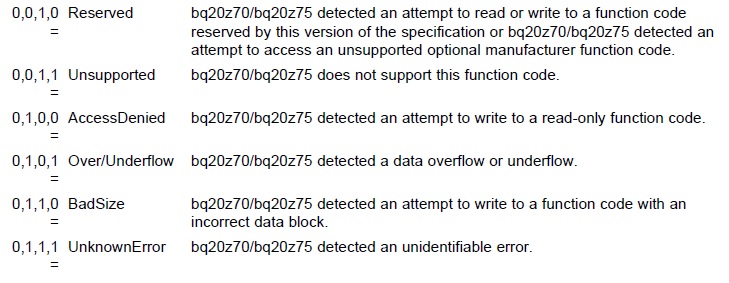

our customer is checking the error code meaning about BQ20Z75-180.
For the Battery status low byte, it shows: 0xc8.
Customer would like to know the meaning of this error code represent
For EC3 to EC0 , it would be 1,0,0,0.
Could you help to recommend this meaning?
