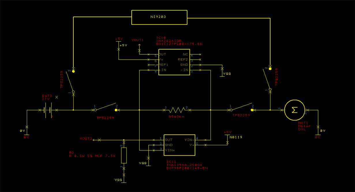

I am looking for a switch circuit to commutate between 2 module of current sensing.
my application has a nominal current of 5A and a strating peak current of 55A.
I have chosen the TPS22959 because it support until 15A  with un ultra low Ron. but the big problem is in the starting current, the TPS22959 support only until 17A.
is there an other switch circuit at Texas Instruments which can support my  starting peak curent of 55A.?
