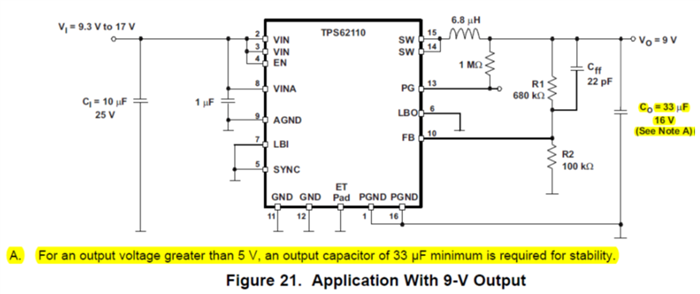

Hi Team,
I understand that “For an output voltage greater than 5 V, an output capacitor of 33 μF minimum is required for stability”.
However, we would like to know the recommended effective capacity of the output capacitor.
Could you please let us know if you have any information?
