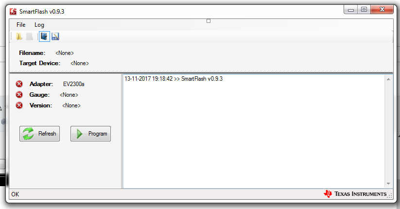

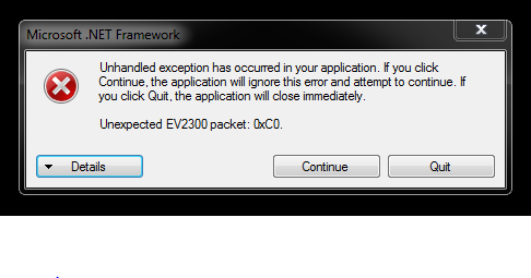

We are using BQ27220 in one of our projects for battery percentage calculation. We have generated the golden image using EV2300, software version 3.1m. When we open smart flash to program the OTP a pop comes with error "unhandled exception is occurred in your application". Image for the same is attached below-
After clicking on tab continue a window opens but there is no version or gauge name (attaching the image for the same)-
please assist on above issue.
  • Hi Aditya,
    Are you able to communicate with the gauge using bqstudio and the ev2300. If so, did you set up your system as described in section B3.2 of the trm?
    www.ti.com/.../sluubd4.pdf. If you are unable to initially communicate with bqstudio, then you should check to make sure your board is functional.
    thanks
    Onyx
  • Hi Onyx,
    Yes, I am able to communicate with gauge using bqstudio and the EV2300. Our board is fully functional i.e. we are able to read data from gauge resistors through the onboard CC2640 microcontroller.
  • I have also tried to install the latest version of .Net, still same error is coming.
    Please assist on the same.
  • pls describe the steps you are following to set up your board and then to program the OTP.
    thanks
    Onyx
  • Hi Onyx,
    Now I am using EV2400 instead of EV2300. SmartFlash is detecting the gauge but when I tried to flash, it failed.
    Logs are showing NAK after I2C write operation (attaching the SmartFlash logs for reference).
    We have made electrical connection to target board and EV2400 according to TRM only and following every step defined in TRM for flashing .OTFS file.

  • Hi Onyx,
    Now we are able to flash in OTP of the gauge.
    Problem was that SmartFlash is not running the command to unseal OTP.
    First I have unsealed the OTP using BqStudio, after that flashed .OTFS file by SmartFlash.
    So, either mention this step in TRM or add provison for the same in SmartFlash itself.
