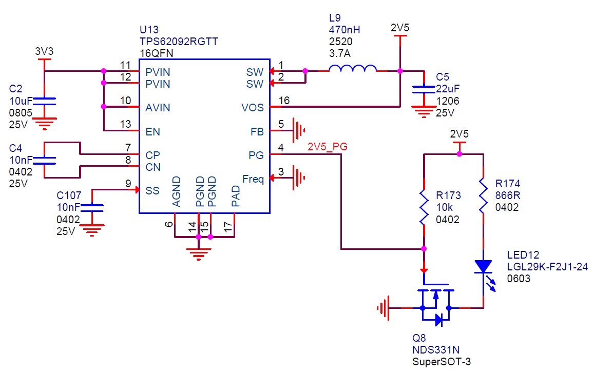

    Thanks for the reply.  Section of the schematics relating to the regulator should be below:
    The component list for all drawn is:
    U13                     TI                  TPS62092RGTT
    C2        10uF       TDK              C2012X5R1E106K125AB
    C4        10nF       TDK              CGA2B2X7R1E103K050BA
    C107    10nF       TDK              CGA2B2X7R1E103K050BA
    L9         470nH    TOKO           1239AS-H-R47M
    C5         22uF      Murata          GRM31CR61E226KE15L
    R173     10k         Panasonic    ERJ2RKF1002X
    R174     866R      Panasonic    ERJ2RKF8660X
    LED12                 Osram          LGL29K-F2J1-24
    Q8                       Fairchild       NDS331N

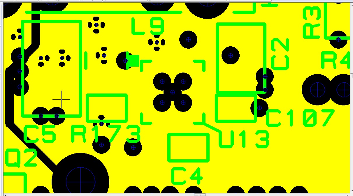

  • Thanks for sharing. Yes, PCB layout and waveforms are needed.

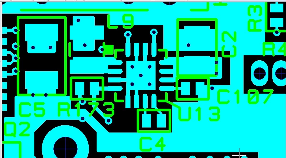

  • PCB layouts, of top metal:

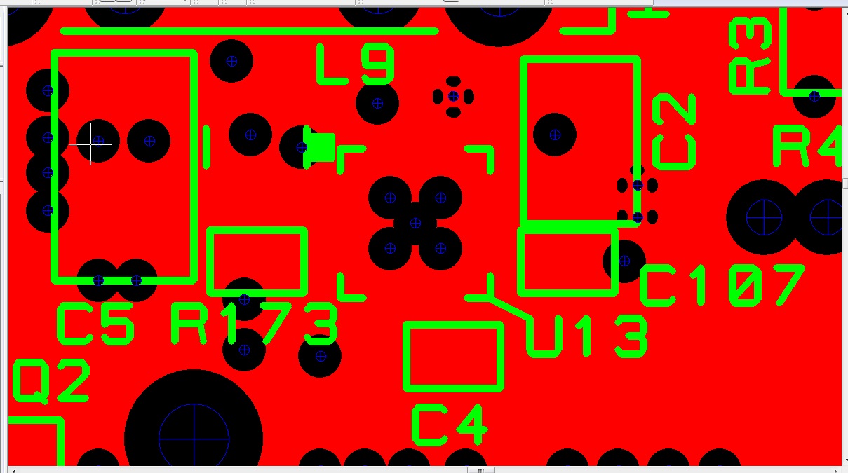

    3.3V inner plane:
    And 2.5V inner plane:
    I'll attempt to capture some waveforms next time the regulator goes wrong.
    Cheers,
    Bryn
  • Thanks for sharing the layout. There are significant improvements that need to be made on the next board spin to get it looking closer to the example in the D/S (Figure 29).
    The input and output cap GNDs need to connect directly to the PGND pins. As well, the inductor should connect to the output cap right next to it without vias.
    You might try adding some metal from the GND plane above the IC to the 2 PGND pins. As well, add a small ~4.7uF output cap from the inductor to the PGND pins (just place the cap above the IC) and add a thicker bus bar wire to connect the inductor the the bigger output cap right next to it.
  • Hi Chris,
    Thanks for the feedback on the layout.  Do any of the issues you noted explain the behaviour we are observing?
    The 4.7uF output cap, what is this for, I couldn't find any mention of it in the data sheet, and when you say from the inductor do you mean the regulator side of the inductor, i.e. the SW output pins, or the cap side of the inductor, i.e. in parallel with the existing output cap?
    Cheers,
    Bryn
  • Yes, layout can make DC/DCs operate differently.
    The 4.7uF cap is just to get a small size (0402) cap where it should be in your layout. It would go from Vout at the inductor to the PGND pins. This is where the 22uF output cap should be.

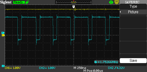

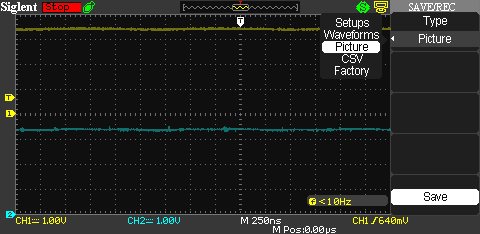

    I've finally managed to get a board returned which has a regulator which consistently exhibits the faulty behaviour, enough so I can capture some waveforms.
    When i first powered it on the regulator seemed to start normally, then after about 30 seconds it went off, then it went through a phase of every power cycle lasting about a second then switching off, including one time I saw the power good bounce up and down many times then settle to off, and now whenever I power cycle it never starts.
    In all the plots below trace 1 (the yellow) is the board that is not working and trace 2 (the blue) is an example board that works perfectly and always has.
    The first plot is the input pin to the device (actually on the positive side of the input cap).  As you can see both are sitting at 3.3 V.

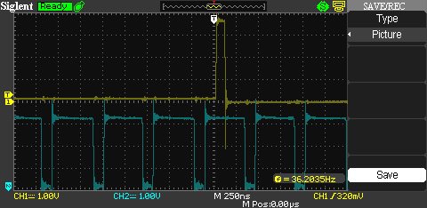

    The next capture is on the output pin of the device (actually on the input side of the output inductor).  As you can see the working one is switching normally, the non working one not, and I had to wait a fair while (10's of seconds) to capture it actually switch, normally it just sits there at about a constant 0.5 V ish.  If i probe the output side of the inductor on the working one I see a constant 2.5 V no switching, and on the broken one the same as the input, so 0.5 V no switching.
    I now moved onto looking at the charge pump, the negative side looks like this:
    And the positive side looks like this:
    As you can see the working board seems to be charging up the one side of the cap, while the non working regulator just seemd to be putting Vin on the positive side, hence why I thought my issue may be with the charge pump circuitry.
    Have you got any ideas, is there anything else you'd like me to capture before I start trying to tack extra components on the board.
    Bryn
  • Hi Bryn,
    Thanks for the update.
    I expect that this failing device is damaged already. Do the CP/CN pins ever switch? For example, can you trigger on SW and see if CP/CN do anything when there is that single SW pulse?
    After that, you could add the caps and see if it helps. Assuming it does not, I would recommend removing this IC and installing it on an EVM. Then, take a new IC and put it on your board. Now, your board should work fine and we can debug the failing IC on the EVM.

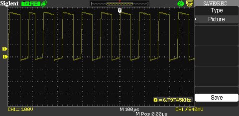

    So with no SS cap attached I thought it was fixed, it ran fine for about 2 weeks solid and then I started noticing the power good, flashing on and off, then occasionally staying off for a bit then fixing itself, it is very sporadic and only seems to be off for 30 seconds or so, but it does keep doing it.  In one of its broken periods I managed to capture the following waveform of the SS pin on the device:
    Bearing in mind there is no cap on this pin anymore, it is completely open, this is a bit peculiar.  It looks quite a repetitive waveform, I wondered if there was anything you could glean from the on / off rate to indicate what the module actually thinks it is doing?
    Cheers,
    Bryn
  • No, that frequency does not tell anything. I suspect that this device is damaged.
