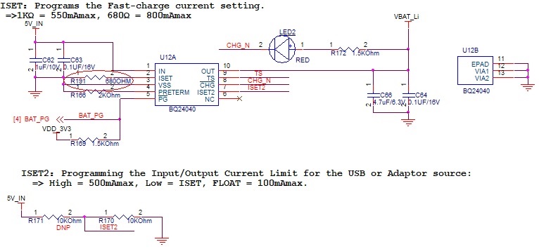

We are implementing the bq24040 to charge a Lion 12000mAh cell., the schematic (SCH) is shown below:
No matter if Input is Active or not , the PG is always stay low level, why is that?
