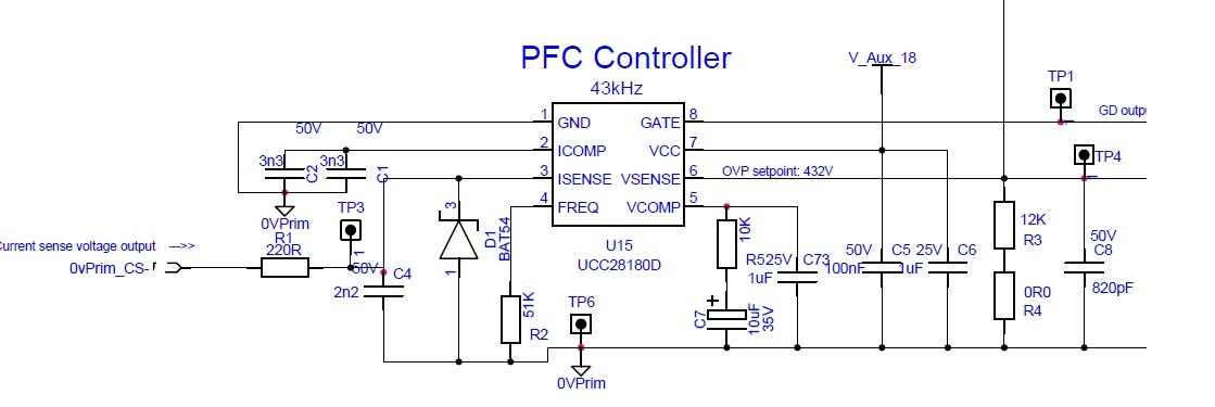

I am designing a 3.5kW PFC LLC converter and I am experiencing audible hissing noise at loads lower than 1kW. Could anyone please suggest a circuit to eliminate this noise.

    Sorry, what  I meant was I am using the UCC28180 PFC controller + a separate IC driving the LLC. Please see the attached schematic

  • Hi Pravin,
    If you are sure that the noise is coming from the pfc stage and not the LCC then I would investigate the boost inductor.
    First test the pfc on a resistive load so that you can be sure that the LLC is not going into a burst mode of operation and causing audio noise.
    Check the inductor current. It should be operating in continuous conduction mode with a switching frequency of 43kHz at this load condition.

  • Hi Pravin,
    Please look at some of the switching nodes. Your 43kHz switching frequency is above the audible frequency range so you must have some lower frequency component at 1kW load.
    The noise is most likely the inductor core responding to this.
    Do you have the construction details for the inductor?
    John
  • Hi John,
    I managed to resolve the issue. One of the underlying copper floods was a 43kHz HV switching node of the PFC which was coupling a square voltage on to the voltage measurements. This made the controller go into and out of OVP causing audible noise. I cut the track area which was passing over the flood and the noise is finally gone.
