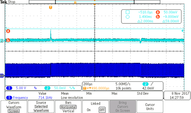

I'm testing TPS54627 dynamic response using our EVM, my input voltage is 5V, output is 1.05V, and the parameter on our EVM is not changed. The circuit is just as below.

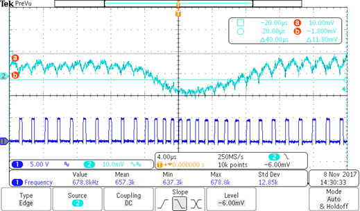

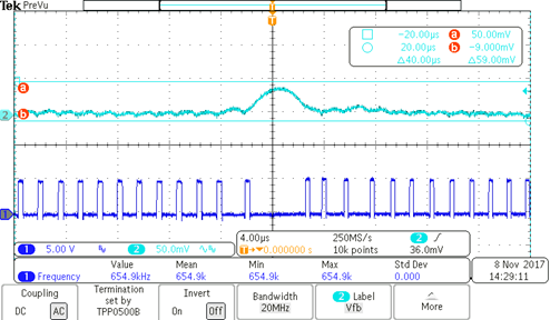

The load switch between 1A and 5A, the dynamic response just as the waveform show. As you can you, the overshoot is for about 45mV, the undershoot is for about 15mV. And I want to know why overshoot is much more bigger than undershoot. I think there may be some relationship with the D-CAP2 mode.
Any comments are highly appreciated.
