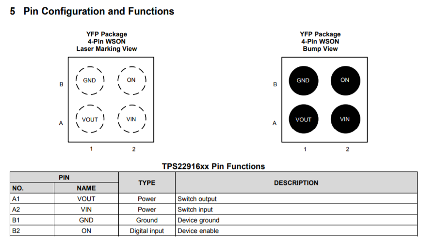

Page 3 of the datasheet shows both a top view and bottom view of the device.    However, the pinout is not mirrored.    More so, the packages are labelled as WSON, when they are clearly BGA devices.
Would someone please clarify which is the correct pinout?
