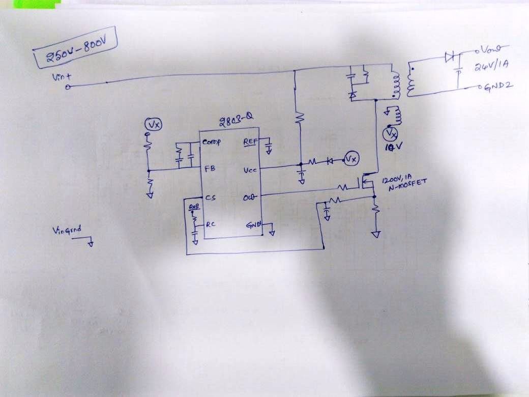

I am looking for the less BOM count design for 250Vin-800Vin DC supply, Where output is 24V/1A.
Can i remove the Opto section and auxiliary VCC section..
Vfeedback can i take from my output i.e 24V ??

      To have the design without using opto, first you need to see if your 24V output has the common ground as the primary side controller.
      If yes, you can directly tie your 24V output to the feedback divider and close the loop.
      If no, you need to use an aux winding to create a voltage on the primary side, like the schematic in your attachment.
      You can also try UCC28730-Q1. It senses output voltage through the auxiliary winding and no opto coupler is needed.
      Let me know if this helps you to understand the options. Drop me a note if you have further questions.

  • Ok. Given you very wide input voltage and large voltage ratio between input and output, you'll need the transformer to help.
     See the attachment for the simplified schematic. You need to figure out the exactly values of the component. But the schematic gives you a starting point. You should add all the necessary functions, such as EMI filters, etc. to meet your final requirements.

  • Hi, Rami,
       This is correct. You might have to play with the aux winding rectifier a little bit to get the best performance.
      I suspect you don't want to have a resistor in series with the aux winding since that adds error to the sensed voltage. But it might smooth out the voltage ringing. You have to test to see which one is the case.
      Another trick you can play is to choose the appropriate rectification diode for the aux winding. If you can use slow diode like general purpose PN junction diode, the slow turn on could help to block the leakage spike and help on the voltage sensing. Same as previous point, you might want to play with the diode selection a little bit with different reverse recovery time and see which one gives you the best results.
      Final point is about the gate driver circuit. I simplified it as a single gate resistor. You might need to adjust that resistor or add diode and resistor in parallel so that you can adjust the turn on and turn off speed independently. We also put a resistor between MOSFET gate to source, at the range about 20kohm to 100kohm to help keep MOSFET off during the start up when IC is not powered up.
      Good luck and have fun with the circuit.

  • Is that schematic correct?
    Can i go for the PCB design..
  • Hi, Rami,
      Sorry for the late response. The schematic is correct.
      You might need to adjust component values but the schematic as it is should be fine.
