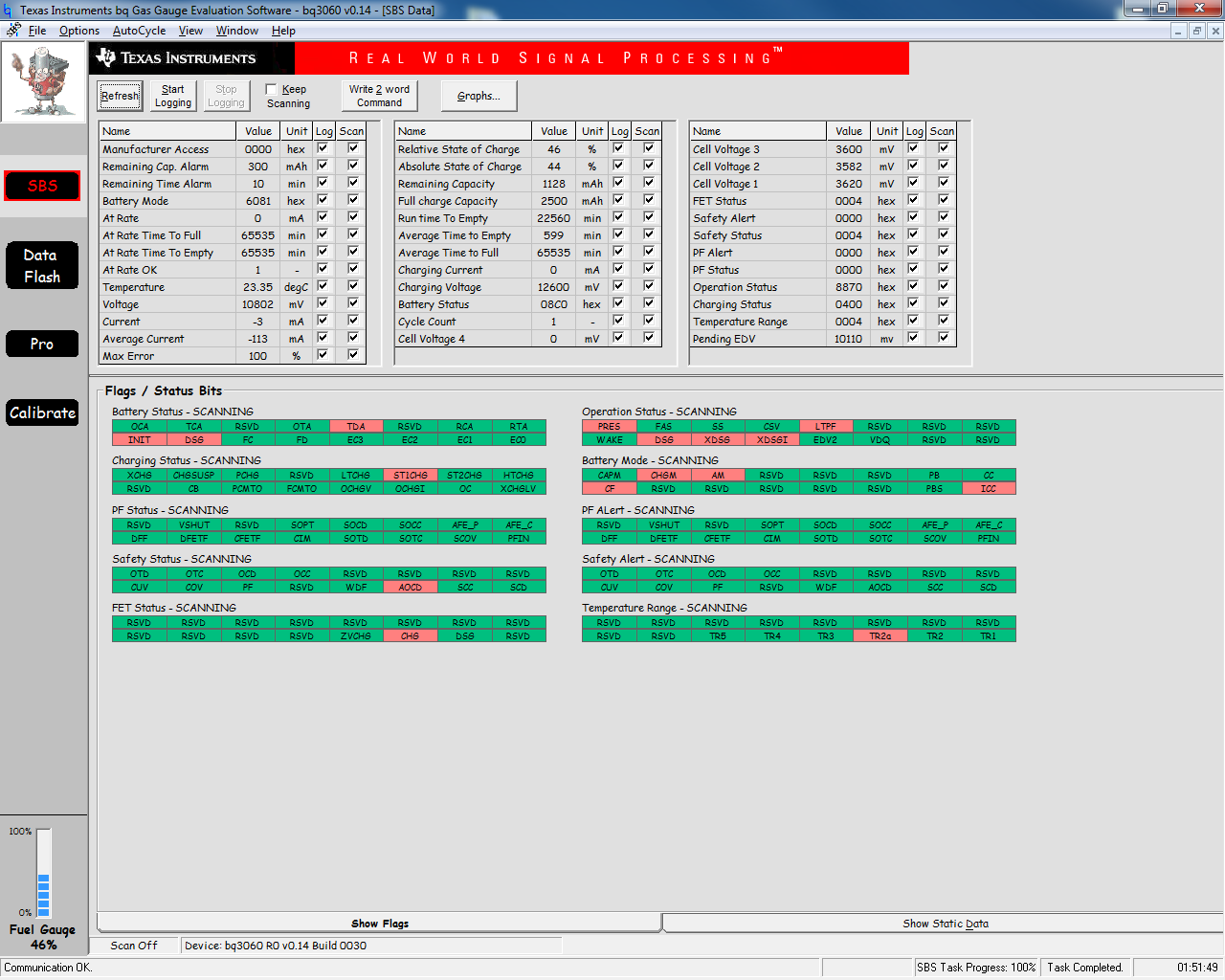

I'm working on programming and calibrating the bq3060 v0.14. I'm using bqEVSW V0.9.90. I have been programming and calibrating several dozens of PCBs. However, I have a problem with some of them.
Loading with current of -2000mA during Pack Current Calibration results in immediate over-current protection. Flags AOCD, XDSG, XDSGI are set and FET Status changed from 0006 to 0004.
OC (1st Tier) DSG is set to 2,2A on all PCBs.
I have empirically stated that the overcurrent protection action is taken betwean 1.7-1.97A for the tested PCBs.
Calibration at lower current (ex. 1A) runs fine, but still when i apply -2A, over-current protection will take action.
When I slowly increase load current I can see theht current is measuret properly by the PCB till overcurrent protection action, at some "thhreshold current value".
This "threshold value" vary from one PCB to another, but for specyfic PCB is always the same. For all problematic PCBs this "threshold values" are in range od 1,7-1,97A.
I've tried to reprogram data flash and multiple calibrations. I've tried also "factory reset" the BQ3060 by reprograming it with default .*senc file (file from this forum & file generated from working PCB) with the same resoult... fail at that "threschold value".
Does Srec programming in PRO tab really wipe all data from the bq3060 chip?
Or should I look for some hardware issues? I suspected FETs but after calibration at ex. 1A, everything works ok. at 1.5A and beyond till that "threshold current value".
 Is there any way to fix this, or do I just have to replace the chip?

    So why don't you use 1A as the calibration current instead of triggering the protection of the gauge with the 2A. calibrating with 1A will have the same effects as using 2A.
    What is your wake current register set to . You need to check what the AFE OC Dsg threshold is set to. Pls next time include a text of your gg file. It will make search through the registers using ctrl F easier.
    thanks
    Onyx
  • Thank you for the reply. Text of gg file is at the end of my previous post. Current of 2A is in normal operating range of the battery pack, so calibration at lower current does not work for me since there is posible fail when loaded with 2A at field. Protection actions should be at 2,2A. The AFE OC Dsg = 00.
  • what current does that correspond to for the AFE OC threshold?
  • AFE State_CTL = 10 ---> RSNS = 1 ---> 5mV steps in OCDV register.
    AFE OC Dsg = 00hex ---> OCDV = 0.025V
    From what I can see on PCB Rsens = 0.01Ohm, so if I think in correct way, based on the Technical Reference AFE OC Dsg = 2.5A.
    Sorry for not giving you precise information. It's my first contact with TI Battery Management solutions. I did not design this hardware or create a *.gg configuration.
  • I've tried "factory reset" the BQ3060 by reprograming it with default .*senc file from this thread e2e.ti.com/.../90431 and also with file generated from working PCB, still the same result.
    To reject possible PCB problems I made a small experiment. I took two configured and calibrated PCBs (Pack Current Calibration at 1A):
    PCB_A with bq_chip_A: switches off at 1.65A load
    PCB_B with bq_chip_B: switches off at 2.21A load
    After I swapped bq_chips:
    PCB_A with bq_chip_B: switches off at 2.20A load
    PCB_B with bq_chip_A: switches off at 1.65A load
    The above suggests a problem with bq_chips... I think. Can anyone confirm / instruct me how to check/ what security mechanism causes such behavior? Because of the XDSG, XDSGI flags and FET status changes from 0006 to 0004 I assumed that this is over-current protection, but I may be wrong.
