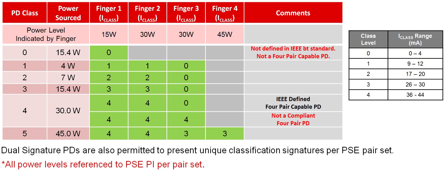

I have some question of TPS2373
1. Do you have 6.25ohm cable's brand and datasheet ?? due to type 4 need 6.25ohm Ethernet cable
2. AC impedance lower than 26.3 kΩ in parallel with 0.05 μF for MPS function ,May I know which schematic have these cap and resistor ?
3. I saw "10- mA pulsed current for at least 75 ms every 325 ms" for 802.3at in datasheet ,but below figure show 300mS and 60mS ,is it correct ?
4. I saw "for Class 5-8 PDs have also increased to 16 mA at the PSE end of the ethernet cable" in datasheet ,but below figure show 14mA ,is it correct ?
5. Can TPS2373 support Dual Signature PD Structure?
