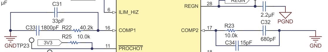

I know that you recommend to use the same value with EVM for COMP pin RC network, then can we choose slightly different value? The customer ask this because they'd like to choose their standard RC value internally. For example;
  • Change C33 from 1800pF to 2200pF
  • Change R22 from 40.2k to 39k or 43k
