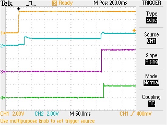

    This is what I get after using an external oscillator for the 32KHz.
    However, it is observed that the output voltages still takes a while to get to stable values. Why is there a step on waveform (3)?
    Included here is the plot:
    1. +3.3VDC
    2. IGNORE
    3. +1.8VDC output from TPS65930 to OMAP3
    4. 32KHZ clock
    Sieow

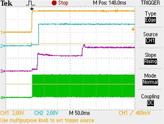

    It will help if you can provide a plot with input, REGEN, VIO and NRESPWRON. I dont think your board is powering up as expected. The power should be done in less than 10msec or so. You can add up all the delays in the data sheet.
    VIO reaching its expected level in more than 150msec is very strange. It will help to see the complete power-up sequence to understand what i shappening on your system.

  • Here is the plot:
    1) +3.3VDC VIN
    2) +1.8VDC VIO
    3) REGEN
    4) NRESPWRON
    +1.8VDC with respect to +3.3VDC does not make sense. The rest of the signals do follow the spec sheet timing for sequencing once the chip gets up to its feet i.e. when REGEN starts.
    There is a delay in stabilizing the 32K even if you are using an external signal. The internal oscillator cannot be bypassed and hence you see the delay. With an external 32K the delay will be lesser than with using a crystal.
    The VIO step you see would be due to the leakage on the internal power domains. The 32K in the device is on the VRTC domain (1.5V). The external 32K you are using is 1.8V. When you use a crystal there is no mis-match between domains. I dont know the source of your 32K. You can try with a 1.5V 32K to eliminate the step.

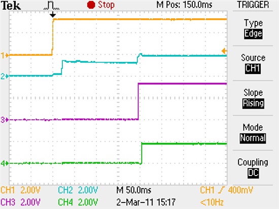

  • Hi!
    The following plots are taken with TPS65930 using crystal for 32K (NOT oscillator) and the step on +1.8VDC is still there.
    1) +3.3VDC
    2) +1.8VDC
    3) REGEN
    4) NRESPWRON
    Top figure: Power off, wait for a few seconds, power on
    Bottom figure: Power off then power on immediately
    Note that the time for the device to come up also varies. Most importantly, the +1.8VDC "leakage" (step) is still there. Note that for these plots I am using crystal so there is no mismatch that could possibly leak all the way from 32K in to VIO (+1.8VDC) output.
    Can your team do similar measurements on your side? The TPS65930 is used to power up OMAP3503 on our side.
    Please see the figure attached. This was on a standalone board. I do not see any step on VIO rail. The VIO rail shows a slight ramp at th ebegining, this is due to the 32K ramp. This board uses a crystal for 32K.

    Aaron sent me another email for an update. Here is what I replied to him. I got an OoO from him, he is traveling and may get back to you a bit later.
    Schematics look fine to me. Something on their board is loading/leaking on the VIO output. Is it possible to isolate VIO on the platform?
    I know this can be tough and IO goes at all places. But I cannot think of any other better way to see how we can isolate. If the traces are on top layer then they can try to cut the trace that provides 1.8V output.

  • Gandhar:
    Good news! I found the leakage from a level translation chip we have downstream from this card. The step issue is resolved.

  • The voltage translation chip was on another card that the schematics I sent to you interface to. Apparently, VCCA and VCCB supply voltages were swapped. The spec is VCCA =< VCCB but on the card that my card was interfacing to VCCA = 3.3VDC and VCCB = 1.8VDC. On top of that, several signals were wrongly connected, essentially causing 3.3VDC to back drive through a few resistors into 1.8VDC. The +1.5VDC step was seen because (3.3VDC - 1.8VDC = 1.5VDC), back-driven from the driver.
    I hope this helps.
