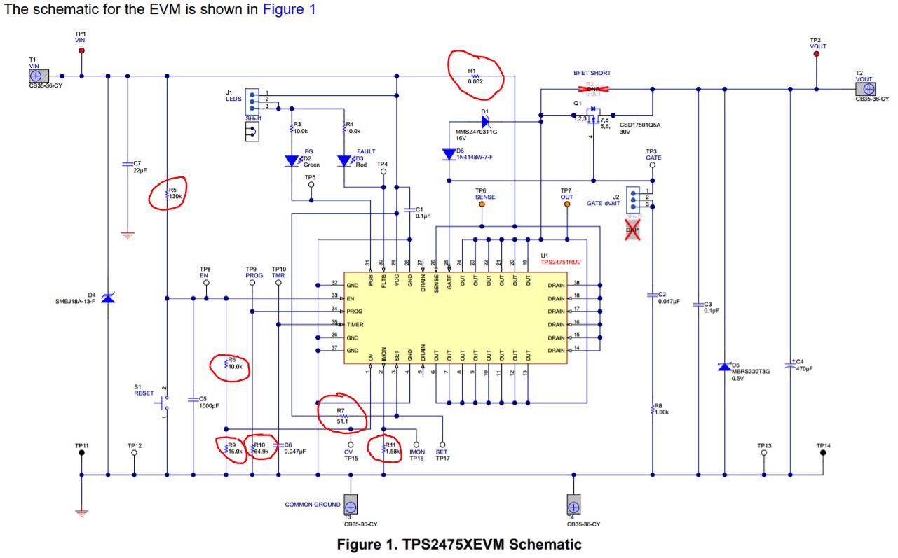

I'm testing TPS24751 like in TPS24751 board evaluation (www.ti.com/.../slvu968.pdf)
I just changed the next values of resistors:
R7 - 51R
R10 - 66k5
R11 - 1k58

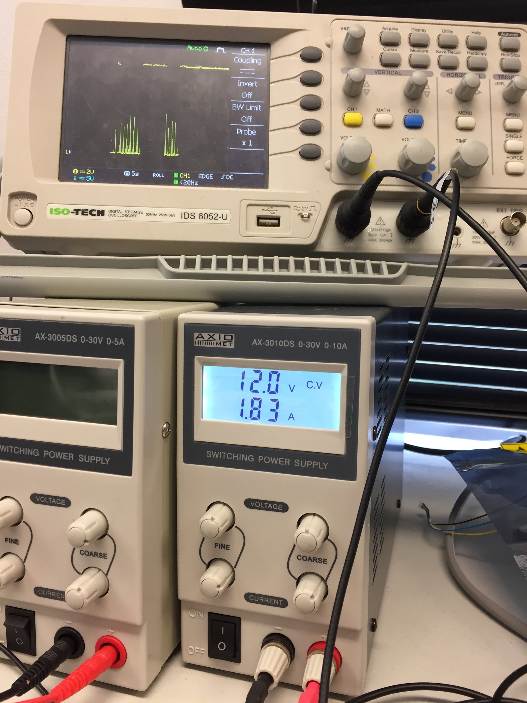

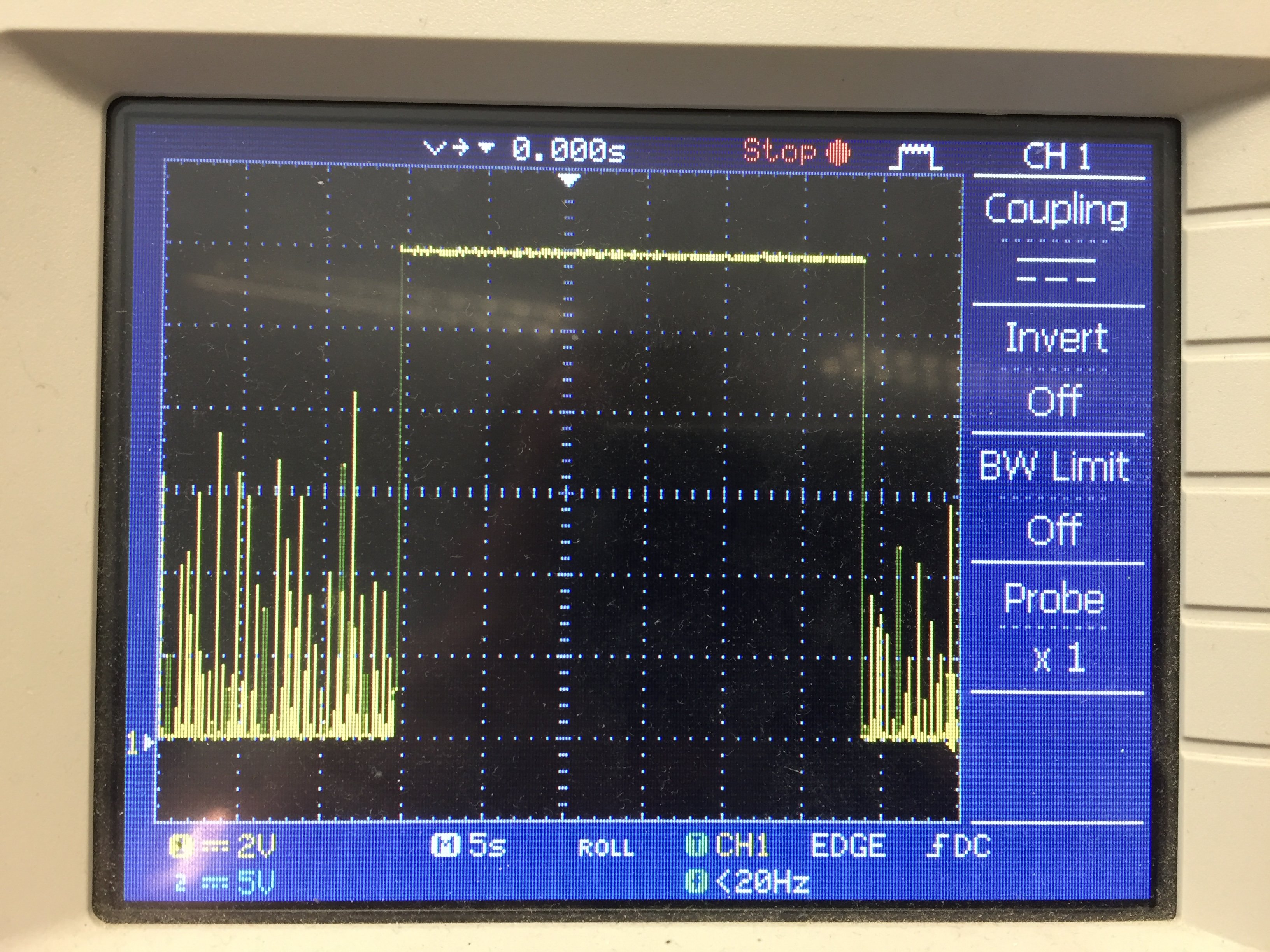

I put a load for 2,2A (with 12V at input) and the load voltage can seen in the next picture. The TPS24750 turn off with this load, and should be just with 11A. What's wrong with the circuit?
