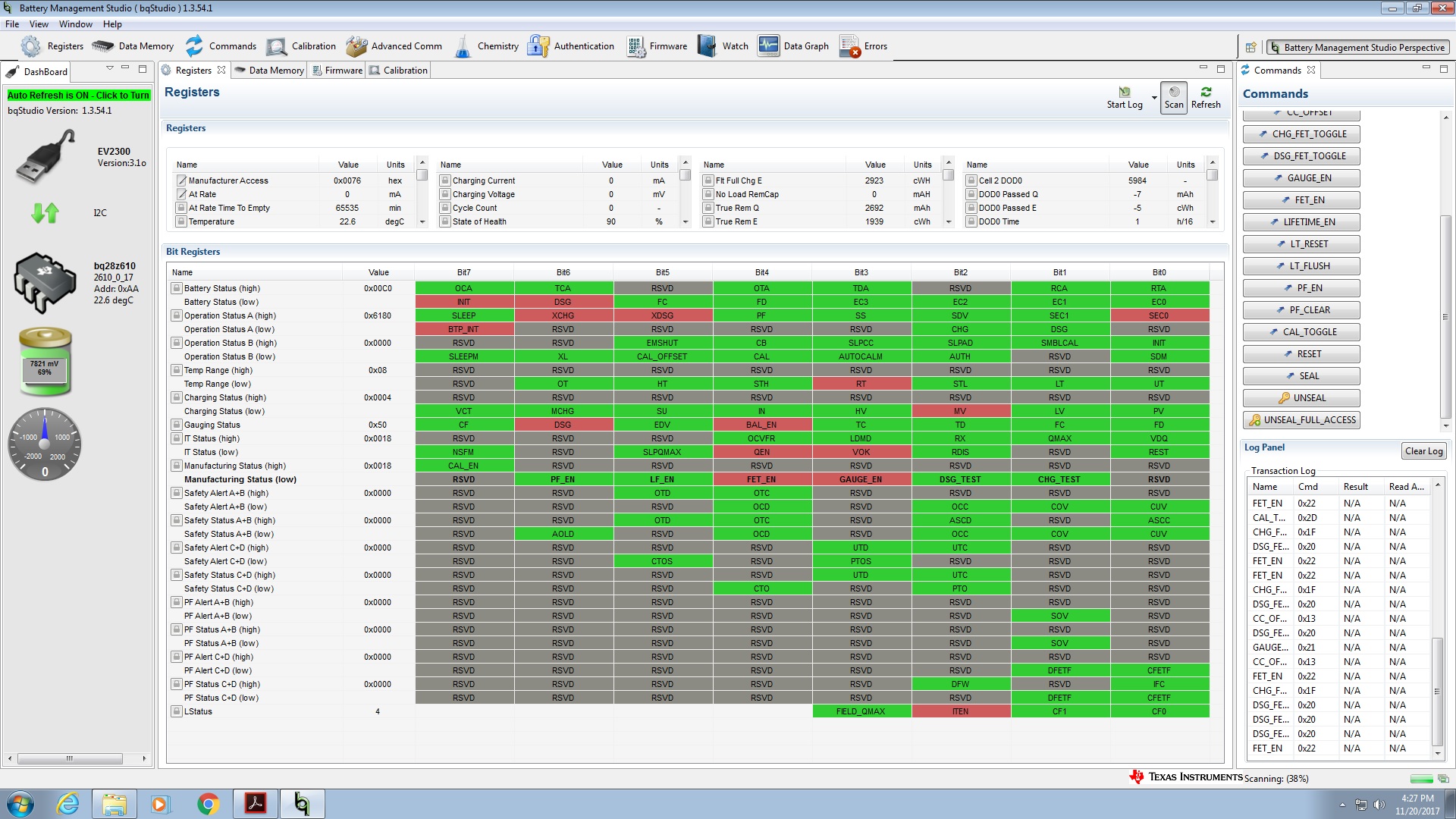

I have an issue with the BQ28Z610. I don't understand why the charge cannot be activated with battery which is not full yet and no alert activated.
Here is a snapshot of my registers :
Do you have any idea why I can't charge my battery with this setup ?
Thanks in advance for your answer.

  • Hi Mickael,
    Your XDSG and XCHG are set, which means the CHG and DSG FETs are disabled. I can't tell why from your register snapshot, what is the issue. Can you provide a GG file and SREC for us to review. Any details about your setup would be helpful as well. What's your charger voltage? Are you using bq28z610EVM?

  • Hi Mickael,
    Damian is on the right track - many bq devices have a PRES pin and a NR bit that when not pulled low or not set can prevent charge and discharge. This particular device does not have these features, but the issue is most likely based on a protection or limit being hit.
    Since you don't have alert flags, a limit being hit is more likely.
    After review of your GG file:
    Please try reducing your battery voltage below 7.8 V when at MV (MV flag is set your in screenshot above). The advanced charge algorithm MV range for your device is currently set at 3900 mV per cell (7800 mV for the series stack).
    If the issue persists, please send a full log and SREC. If the above answers your question, please click on "This Resolved my issue" button to benefit others who have the same issue.

  • Hi Bryan,
    Thanks for your reply. I tried to reduce the battery voltage but the charge doesn't start.
    I ask my client another board and it's working now. I think the one they give me have wasn't functional.
    Now the problem is resolved.
