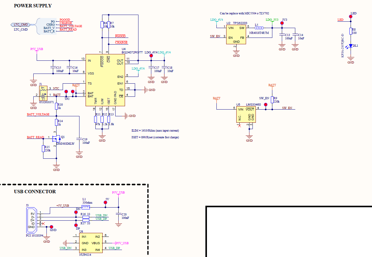

i have the BQ24072 on my system, my schematics is
and i have problem with some device when they are in charge. On some device happen that after some hour in charge i have the pin CHG high (that indicate battery charged) but when i disconnect the usb and measure the battery this is not at 4.2V but in this last test was at 3.60V.
Before the test i have check that the pin PGOOD was VSS (that indicate a power supply).
Can you help me?
