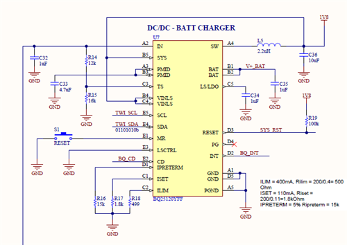

    On the situation where you are unable to go to Ship Mode- (#1)- You will always go to Ship Mode as long as /CD pin is high and you are able to talk to the part on I2C.Can you share some schematics and scope captures? ( i am curious on the /MR side and also would like scope captures of PMID/VIN/VBAT)

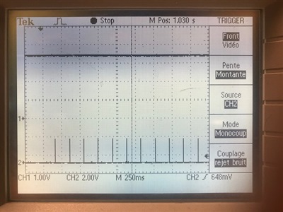

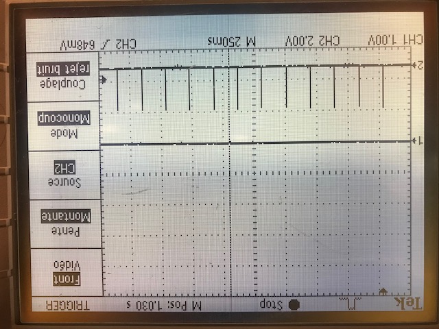

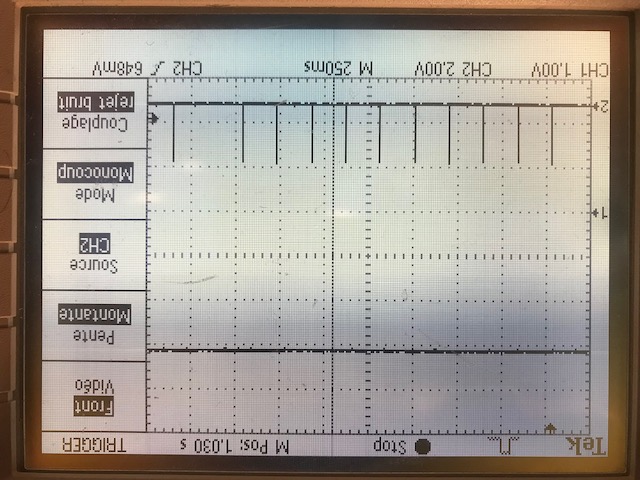

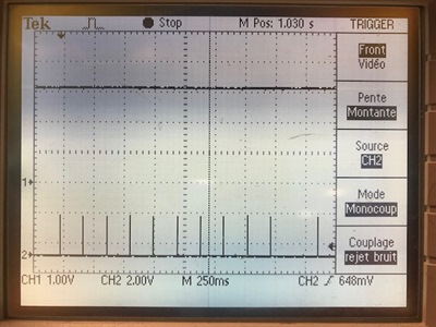

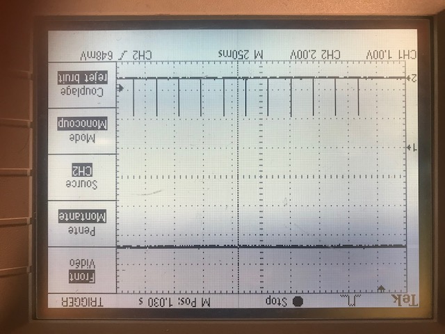

    #1:
    Here is the BQ part schematic (VIN is tied to a wireless power receiver output, 5V nominal):
    On the following scopes, channel 2 is used to trigger (each pulse represents the SW trying to enter shipmode):
    PMID:
    VBAT:
    VIN (charger is not attached):

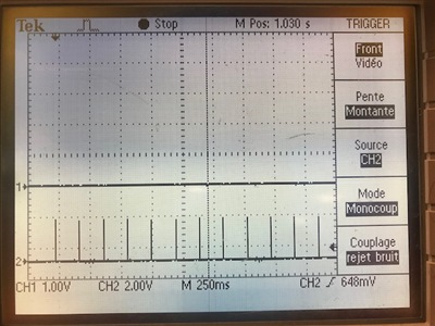

    #3
    Here is PMID:
    For I2C comms, we used a saleae to record frames (you will need logic by saleae to view this file).
    i2c_bq_attempt_shipmode.zip
    As you will see, we begin by reading all BQ registers to clear fault flags, then we write 1 to the EN_SHIPMODE bit, and then try again if it did not succeed. The blank times between frames are due to sleep commands.
