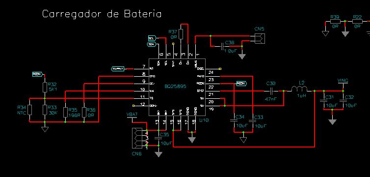

Hello Jeff, long time since our last contact... just to notify you, I had to redesign the PCB to reach 2A of charge.
For your reference, our fisrt conversation is on the link:
e2e.ti.com/.../622771
Now, the doubt is: I cannot reach the VSYS fixed on 3.5V as configured when the battery drops below this voltage. The VSys voltage is following the VBat voltage even when VBat is below 3.5V.
The register configuration is bellow:
Reg00 = 0x26; //  - 2A de carga
Reg01 = 0x0A; // Reg01 - VINDPM = 1V
Reg02 = 0xF0; // Reg02 -
Reg03 = 0x1A; // Reg03 - VSys 3.5V, Charger Enabled,
Reg04 = 0x20; // Reg04 - Fast Charg Current LImit to 2048mA
Reg05 = 0x33; // Reg05
Reg06 = 0x5E; // Reg06
Reg07 = 0xCD; // Reg07
Reg08 = 0x03; // Reg08
Reg09 = 0x44; // Reg09
Reg0A = 0x93; // Reg0A
Reg0D  = 0x12
The circuit is:
Could you please give me a tip?
Thanks in advance...
Ivan
  • Hi Ivan,
    Can you send the remaining registers with the status/fault bits?  Those will tell me if the device is INDPM, VINDPM, Thermal Reg, NTC fault, etc.  What is the load on VSYS?  If VSYS=VBAT then the device is in supplement mode, meaning the load on SYS is greater than the input power can provide.

    In both cases, the VSys = VBat (not respecting the VSysmin = 3.5).
    The VSys load has around 60mA constinuously and some peaks of 1ms of 1A~1.3A. The load is a Sierra's GSM module only... I have two tantalum capacitors of 100uF each on this line to minimize the peaks impact.
    Another important information is that I intend to use BatFet to reset the VSys power supply if the module freezes. It's not implemented yet, but I'm thinking to use BATFET_DIS bit on Reg09 bit 5 to do that. Should I take care of HiZ mode also? To turn off VSys, I must make sure that HiZ is enabled and then turn off the BatFet. To turn on VSys back, I must disable HiZ and then allow BatFet to turns on. Is it?
