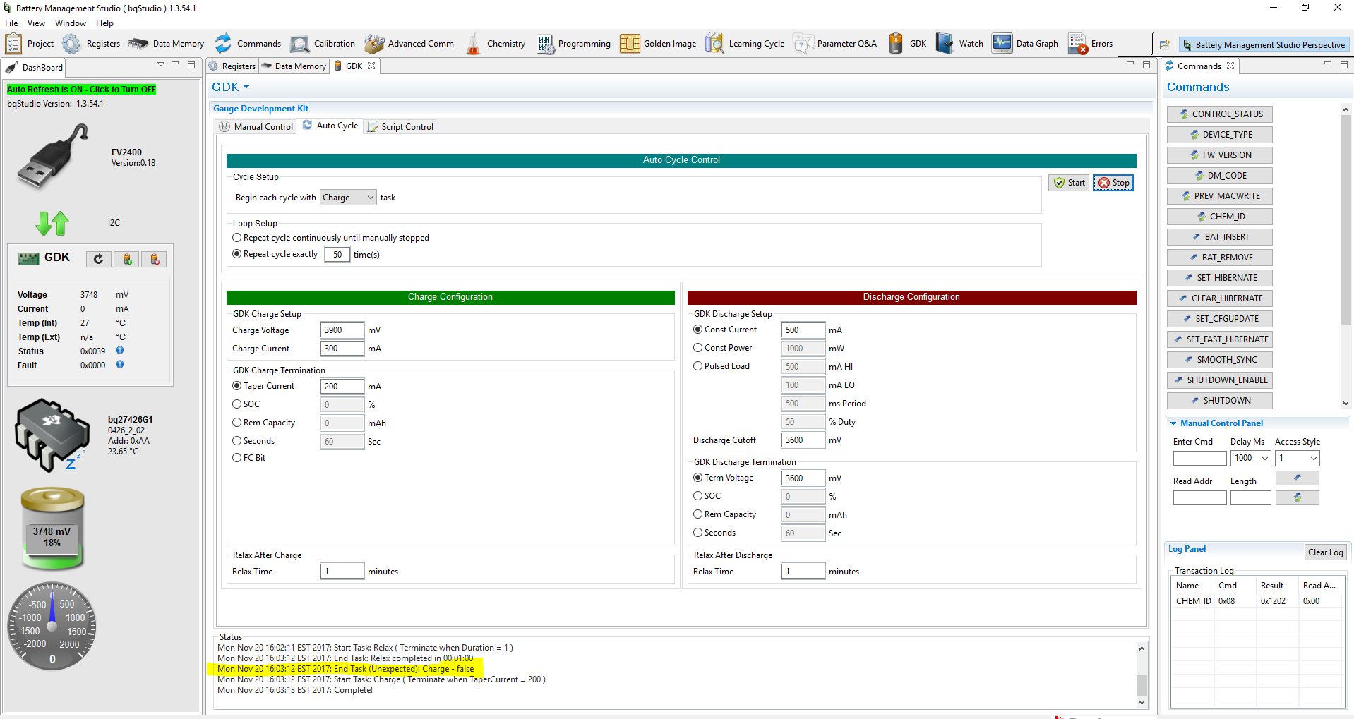

I am trying to cycle the battery around 100 times to see the fuel gauge accuracy performance.
Josh
Josh
Hi Damian,
We are still seeing errors when discharging with 10mA taper current and 10min relax time for Charge/Discharge. See below:
Wed Nov 29 18:46:24 EST 2017: Start Task: Discharge ( Terminate when TerminateVoltage = 3300 )
Wed Nov 29 19:41:34 EST 2017: End Task: Discharge completed in 00:55:09 - Termination Voltage Reached
Wed Nov 29 19:41:34 EST 2017: Start Task: Relax ( Terminate when Duration = 10 )
Wed Nov 29 19:51:34 EST 2017: End Task: Relax completed in 00:10:00
Wed Nov 29 19:51:34 EST 2017: Start Task: Charge ( Terminate when TaperCurrent = 10 )
Wed Nov 29 22:13:35 EST 2017: End Task: Charge completed in 02:22:01 - Taper Current Reached
Wed Nov 29 22:13:35 EST 2017: Start Task: Relax ( Terminate when Duration = 10 )
Wed Nov 29 22:23:35 EST 2017: End Task: Relax completed in 00:10:00
Wed Nov 29 22:23:36 EST 2017: End Task (Unexpected): Discharge - false
Wed Nov 29 22:23:36 EST 2017: Start Task: Discharge ( Terminate when TerminateVoltage = 3300 )
Wed Nov 29 22:23:38 EST 2017: Complete!
