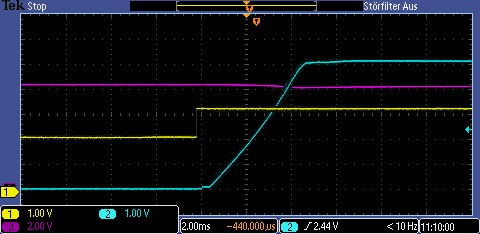

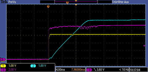

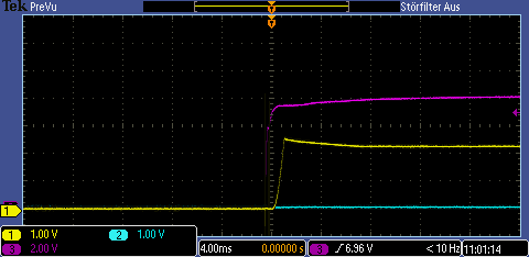

  • I have checked the Vcc start up
    yellow Vcc Pin
    purple V_in +8V
    blue V_out +5V
    good power supply:
    not working power supply:
    applying 3,2V to the Vcc Pin of not working power supply
    If you remove the external supply to the VCC will the part still operates?
    Also is the VCC capacitor working ok with it's rated voltage? What happened if you substitute the VCC capacitor? That is just to double check that the capacitor is not leaking and causing VCC to drop.
  • If you remove the external supply to the VCC will the part still operates?
    Yes, until I unplug the complete system and restart it.
    I replaced the capacitor already => no change in the behaviour.
    The Vcc is quite strong. I put an external resistor as a load to VCC (just for a test). When Vcc was at 3,2V an the IC was working, a resistor with 10 Ohm did not change much at Vcc (I applied the resistor just for a few seconds). When Vcc was at 2,4V (IC not starting), the votage at Vcc dropped when I put an external load on.
