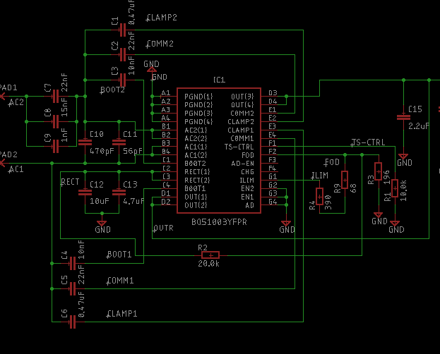

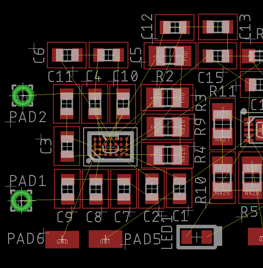

I am designing a PCB for wireless charger using BQ51003. I am facing problem in pulling out the signals from AC, CLAMP and FOD pins, as they are in the inner portion of IC.
Can anyone please suggest a way to do it?

  • Take a look at TIDA-00318
    www.ti.com/.../TIDA-00318
    This is a design with bq51003 and the design files and gerber files are available for download.
  •  Hello Mr. Johns,
    Thank you for the response. I am facing issue with BGA package. And I couldn't find any solution in the TIDA-00318 designs.
    As you can see in the attached image, I used a capacitance of 10uF and 4.7uF at RECT and 2.2uF at OUT. I considered these values following the schematics document that is given in project design files in TI website.  I expect an output of 400mA at the Receiver end. But, the values that mentioned in the specifications document are completely different. I want to confirm if I can expect an output of 400mA at this receiver end. Please check the values given in the attached image.
    Also, the RECT and OUT bypass capacitors are at a distance as displayed in the second image. Would this anyway affect my output? Here, C12, C13 are my RECT capacitors and C15 is the OUT bypass capacitor.
