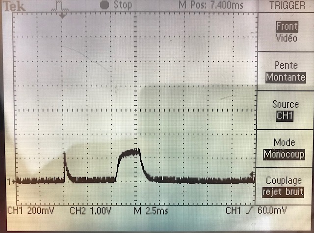

We seem to have an issue with the BQ25120 when it comes to charging a battery pack that has a blocked PCM, meaning VBAT = 0V, because of overdischarge.
To be unlocked, there should be a current injected into the battery so that the PCM re-opens the power path, however when plugging in a blocked battery and then a valid VIN (4.96V), the BQ does not do anything: no current measured on the battery cables, still 0V at its terminals.
There is only a small glitch on VBAT as you can see here:
Figure: VBAT when 5V is put on VIN
