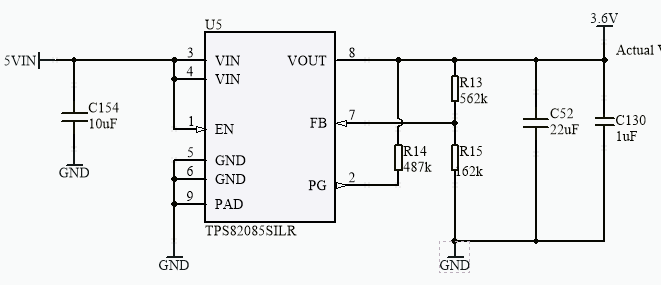

I have just starting soldering down TPS82085 modules. Below is my schematic.
I have soldered U5, R13,R15, R14, C52.   I have NOT soldered C154,C130. There is NO load on the device so nothing is fed by 3.6V

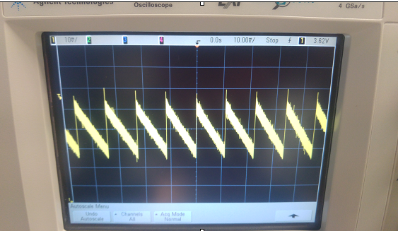

Measuring VOUT with the scope I get the image below. The period of the sawtooth is about 13ms.
Is this expected? Why so much current is drawn without any load?
    The scope plot is not very clear (AC or DC coupling? What is the vertical and horizontal resolution?).
    Please repeat the test by soldering the mandatory input capacitor. The PCB layout should follow the recommendations in the data sheet.

    The vertical resolution is 10mV/Div and 10msec/Div. The trigger level shown as T on the vertical axis is at 3.62V. So the scope is DC coupled. The waveform has 3omV peak to peak ripple around 3.6V with a ~100Hz frequency.
