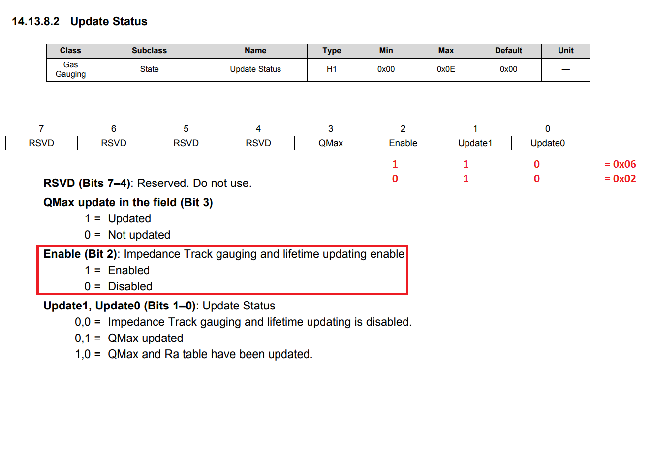

My question is regarding step 5:
Why is it needed to change Update Status from 06 to 02. This means Impedance Track gauging and lifetime updating is disabled (see attached screenshot)?

  • Hi pebl97,
    These are the instructions for creating a golden file for production.
    Setting the Update Status to 02 and Cycle Count to 0 is a step in creating the golden file used to flash all your devices in production.
    This is to ensure the device does not start logging/calculating lifetime/counting cycles during production until after the IT Enable command is set and the device sealed, the final steps in production.
    After the pack is programmed with the golden file and the pack connected, to set update status (IT Enable), please send the update status to 0x06 command to the device prior to sealing the device.
