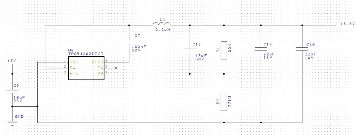

TPS54202: OUTPUT 0V with EN pin Floating
Part Number: TPS54202
I am using the TPS54202 with VIN = 5V, VOUT = 3.3V, IOUT = 0.6A. I should be always enabled: so I left the EN pin floating, but it is OFF (0V on output) both with load (6 Ohm = 0.6A) and without load.
I tested two boards so I think it is not a matter of misfunctionality of a single device.
I sow that the EN pin is at 0V: I expected to be at a voltage over the threshold thanks to the internal pullup.
And when I connect EN pin to a 20K pullup to an external 1V8 the device start working providing VOUT = 3.3V.
What's wrong on my design?
