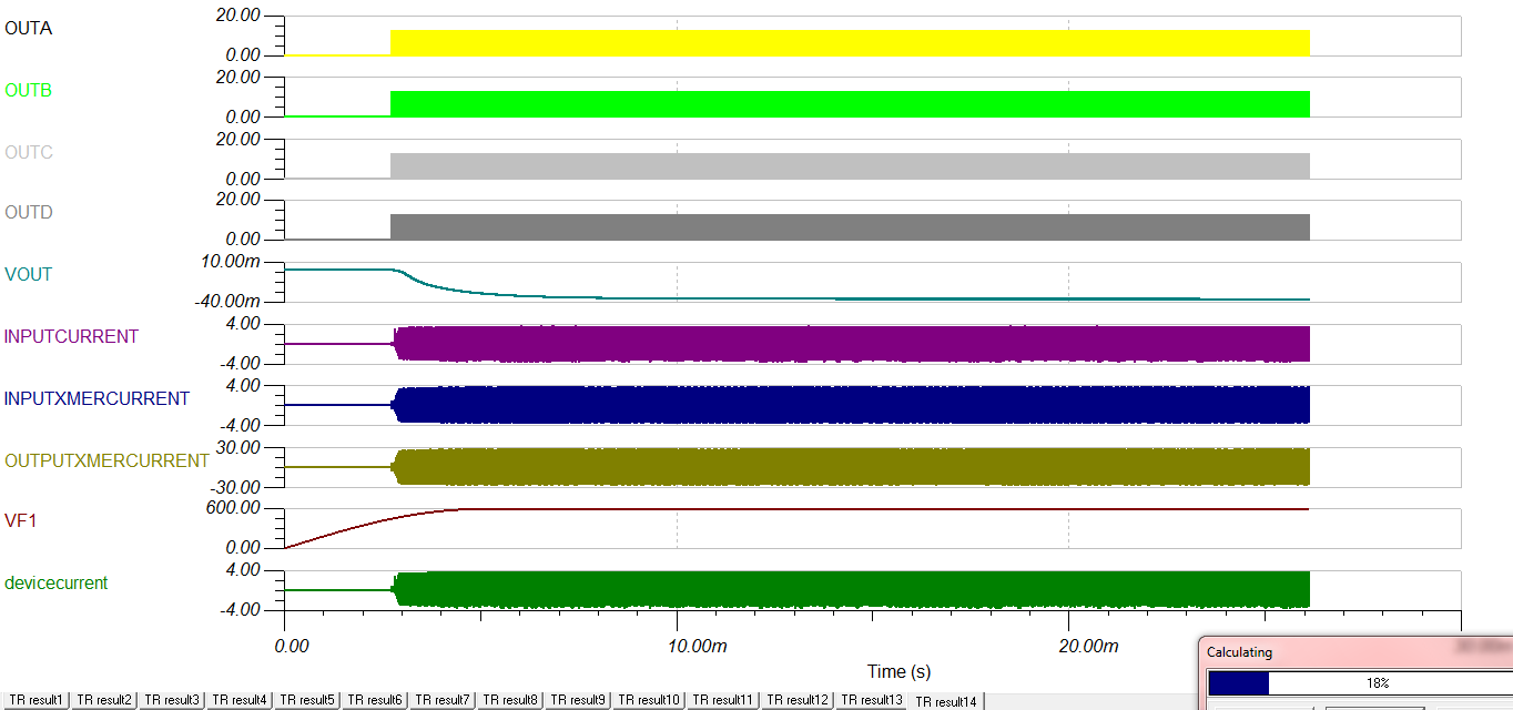

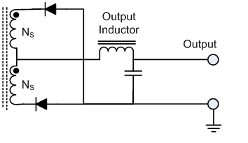

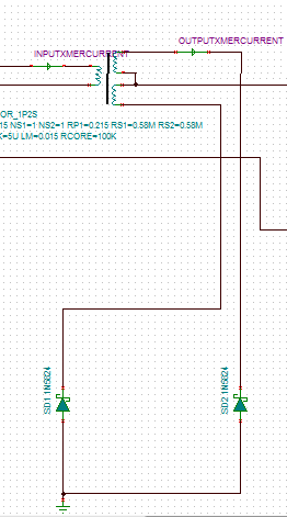

In the design I want to remove the synchronous rectification. I tried replacing with the shottky diodes given under semiconductors library but my output is not at all going towards required 24v value?
its actually going on negative side? am I doing something wrong in Shottky diodes parameters ? i only changed breakdown voltage to 100V as my expected diode reverse voltage is 75V and maximum forward current to 40 A. as rated current is 20 A.
or do I need to change the PI values ?
or the RCD clamp is needs to be changed? If so? how should I do that? any references?
