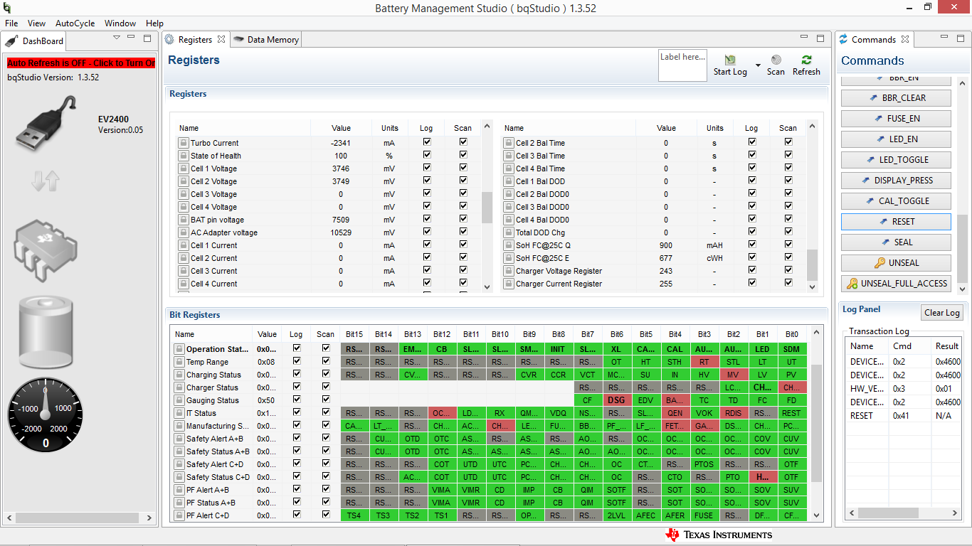

    Thanks for the log. Could you send another with a bit more resolution? Perhaps 4s intervals instead of 30s. Please also provide a schematic and details on the PRES pin operation.
    Something to look closer at: On the 5th sample, in Operation Status A the SS flag asserts and charging is disabled.

  • I have found my problem. As mentioned in this thread:
    My problem was the HWDF flag in Safety Status C+D was set and disabled charging.
    This was quite hard to detect because HWDF is "Flag SBS Host Watchdog Timeout", which get set (apparently, couldn't find anything in documentation) after 5 seconds without SBS communication. And it resets when a communication occur. Therefore, when getting the data from the bq40z60 using bqStudio, this flag is reset before the value is sent. BUT not every time, certainly because of race condition between updating of the flags value and sending it. So after several retry, I manage to capture this flags value at 1:
    Setting the bit HDF to 0 in Enabled Protections C fixed my issue.
