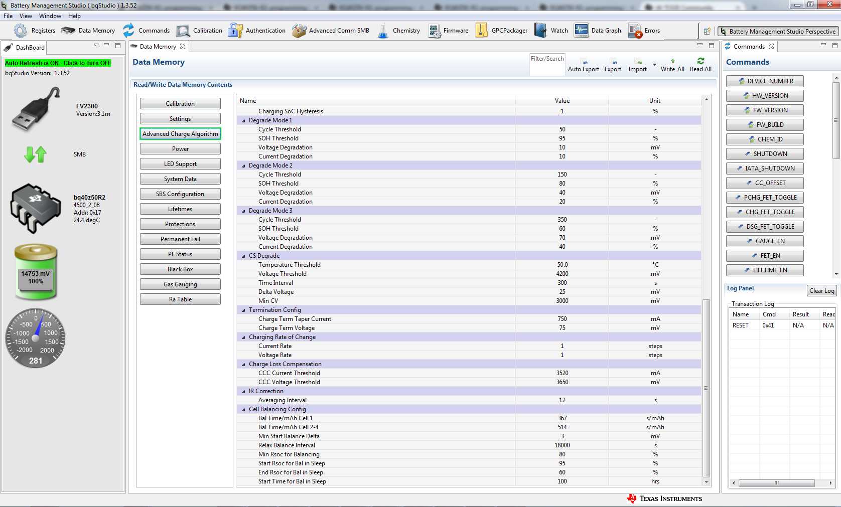

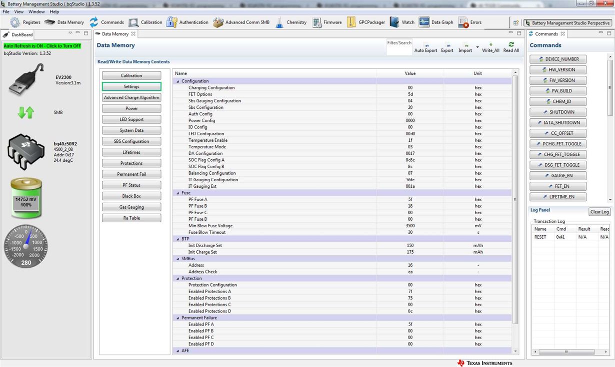

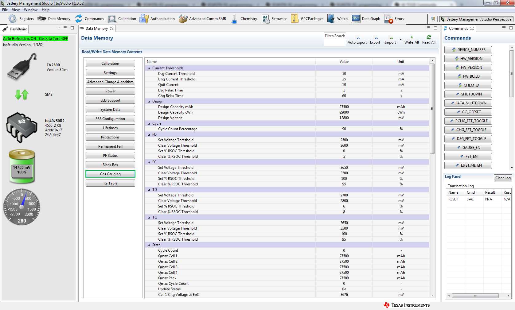

I got an issue regarding bq40z50-r2 cell blancing, I cannot get BQ40Z50-R2 cell balancing function, please help me to know how I can get it function.On circuit board, the original device is bq40z50-r1, later I programmed it with R2 version .srec file, the device is updated to r2.
In my fuel gauge file, Balancing Configuration setting is 0x07, Cell Balancing Confi: Bal Time/mAh Cell1 is 367 s/mAh; Bal Time/mAh Cell 2-4 is 514 s/mAh; Min Start Balance Delta 3mv; Relax Balance Interval is 18000 s;Min Rsoc for Balancing is 80 %;Start RSOC for Bal in Sleep is 95 %;End Rsoc for Bal in Sleep is 60 %; StartTime for Bal in Sleep is 100 hrs. Update Status is 0x0e

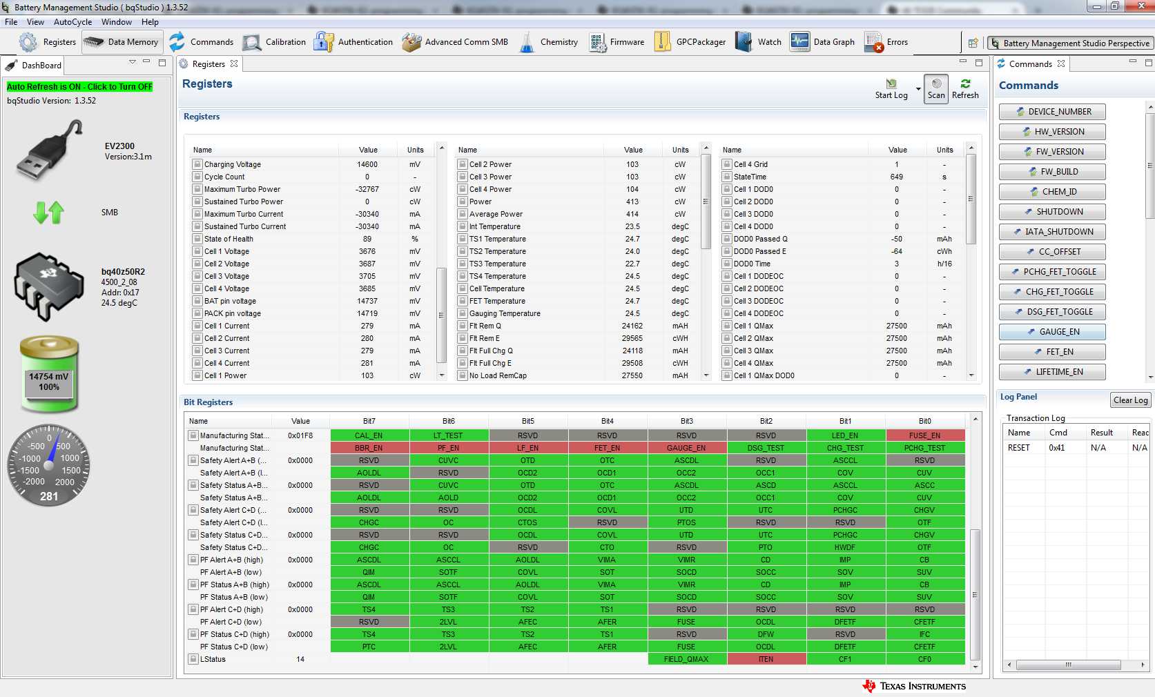

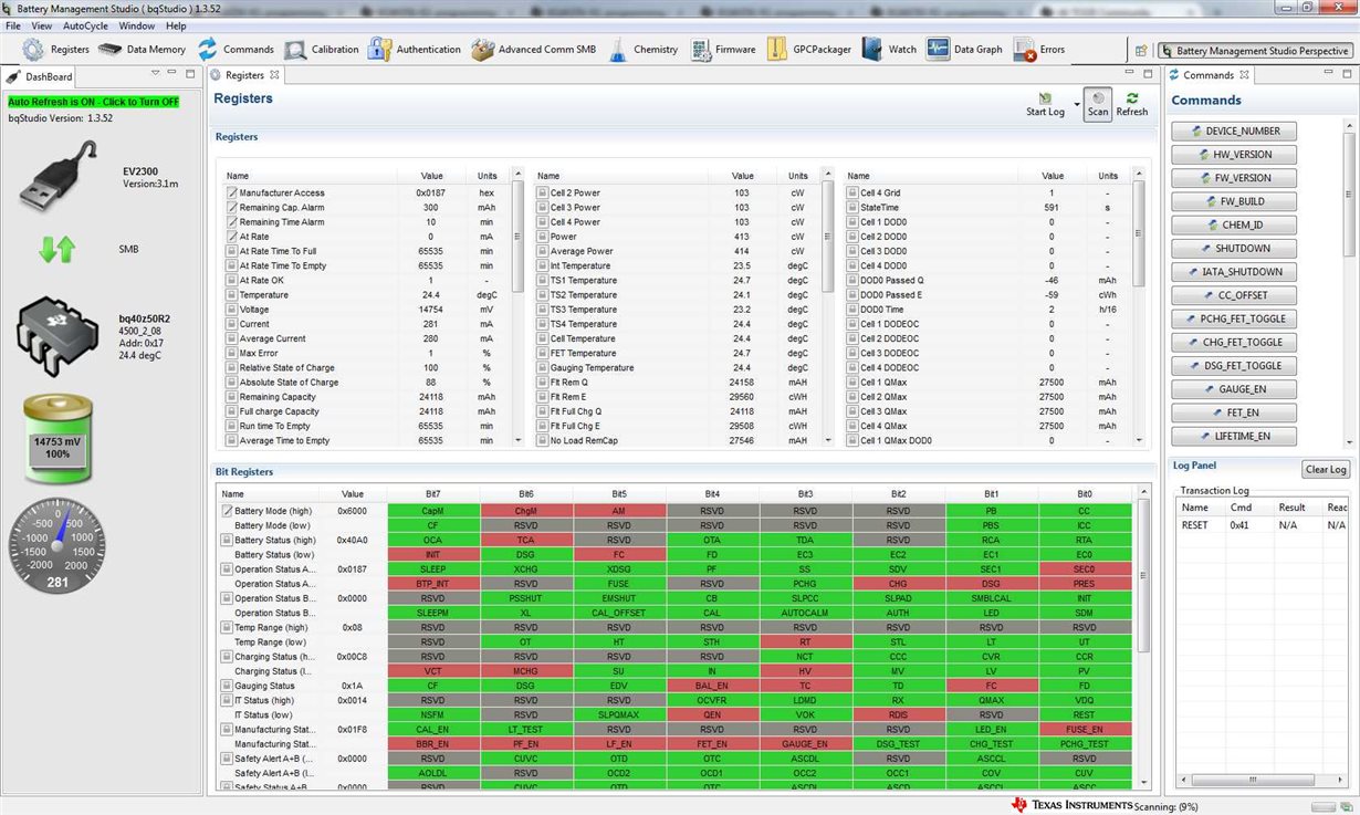

After power up the circuit board, RSOC reading is 100%, cell voltage are: cell1 3676mv, cell2 3686mv, cell3 3705mv, cell4 3684mv.
But no matter during a charging or a relax mode, under both of the conditions, I cannot get CB bit of Operation Status B set. I cannot see cell balancing working.
This is very urgent, my customer is waiting the circuit boards.
Please help me to know why cell balancing cannot work and how I should do to get it working.
Thank you very much!

    Settings Configuration Balancing Configuration 7 hex

    Advanced Charge Algorithm Cell Balancing Config Bal Time/mAh Cell 1 367 s/mAh
    Advanced Charge Algorithm Cell Balancing Config Bal Time/mAh Cell 2-4 514 s/mAh
    Advanced Charge Algorithm Cell Balancing Config Min Start Balance Delta 3 mV
    Advanced Charge Algorithm Cell Balancing Config Relax Balance Interval 18000 s
    Advanced Charge Algorithm Cell Balancing Config Min Rsoc for Balancing 80 %
    Advanced Charge Algorithm Cell Balancing Config Start Rsoc for Bal in Sleep 95 %
    Advanced Charge Algorithm Cell Balancing Config End Rsoc for Bal in Sleep 60 %
    Advanced Charge Algorithm Cell Balancing Config Start Time for Bal in Sleep 100 hrs

    Gas Gauging Current Thresholds Dsg Current Threshold 50 mA
    Gas Gauging Current Thresholds Chg Current Threshold 25 mA
    Gas Gauging Current Thresholds Quit Current 10 mA
    Gas Gauging Current Thresholds Dsg Relax Time 1 s
    Gas Gauging Current Thresholds Chg Relax Time 60 s
    Gas Gauging Design Design Capacity mAh 27500 mAh
    Gas Gauging Design Design Capacity cWh 29000 cWh
    Gas Gauging Design Design Voltage 12800 mV
    Gas Gauging Cycle Cycle Count Percentage 90 %
    Gas Gauging FD Set Voltage Threshold 2500 mV
    Gas Gauging FD Clear Voltage Threshold 2600 mV
    Gas Gauging FD Set % RSOC Threshold 0 %
    Gas Gauging FD Clear % RSOC Threshold 5 %
    Gas Gauging FC Set Voltage Threshold 3650 mV
    Gas Gauging FC Clear Voltage Threshold 3500 mV
    Gas Gauging FC Set % RSOC Threshold 100 %
    Gas Gauging FC Clear % RSOC Threshold 95 %
    Gas Gauging TD Set Voltage Threshold 2700 mV
    Gas Gauging TD Clear Voltage Threshold 2800 mV
    Gas Gauging TD Set % RSOC Threshold 6 %
    Gas Gauging TD Clear % RSOC Threshold 8 %
    Gas Gauging TC Set Voltage Threshold 3650 mV
    Gas Gauging TC Clear Voltage Threshold 3500 mV
    Gas Gauging TC Set % RSOC Threshold 100 %
    Gas Gauging TC Clear % RSOC Threshold 95 %
    Gas Gauging State Cycle Count 0 -
    Gas Gauging State Qmax Cell 1 27500 mAh
    Gas Gauging State Qmax Cell 2 27500 mAh
    Gas Gauging State Qmax Cell 3 27500 mAh
    Gas Gauging State Qmax Cell 4 27500 mAh
    Gas Gauging State Qmax Pack 27500 mAh
    Gas Gauging State Qmax Cycle Count 0 -
    Gas Gauging State Update Status 6 -
    Gas Gauging State Cell 1 Chg Voltage at EoC 3650 mV
    Gas Gauging State Cell 2 Chg Voltage at EoC 3650 mV
    Gas Gauging State Cell 3 Chg Voltage at EoC 3650 mV
    Gas Gauging State Cell 4 Chg Voltage at EoC 3650 mV
    Gas Gauging State Current at EoC 250 mA
    Gas Gauging State Avg I Last Run -5244 mA
    Gas Gauging State Avg P Last Run -6709 cW
    Gas Gauging State Delta Voltage 4 mV
    Gas Gauging State Temp k 0.4 °C/256mW
    Gas Gauging State Temp a 12427 s
    Gas Gauging State Max Avg I Last Run -5904 mA
    Gas Gauging State Max Avg P Last Run -6838 cW
    Gas Gauging Turbo Cfg Min Turbo Power 0 cW
    Gas Gauging Turbo Cfg Ten Second Max C Rate -2 C
    Gas Gauging Turbo Cfg Ten Millisecond Max C Rate -4 C
    Gas Gauging Turbo Cfg High Frequency Resistance 15 mOhm
    Gas Gauging Turbo Cfg Reserve Energy % 0 %
    Gas Gauging Turbo Cfg Turbo Adjustment Factor 1 -
    Gas Gauging IT Cfg Load Select 7 -
    Gas Gauging IT Cfg Fast Scale Load Select 0 -
    Gas Gauging IT Cfg Load Mode 0 -
    Gas Gauging IT Cfg User Rate-mA 0 mA
    Gas Gauging IT Cfg User Rate-cW 0 cW
    Gas Gauging IT Cfg Reserve Cap-mAh 0 mAh
    Gas Gauging IT Cfg Reserve Cap-cWh 0 cWh
    Gas Gauging IT Cfg Predict Ambient Time 2000 s
    Gas Gauging IT Cfg Design Resistance 96 2^-10ohm
    Gas Gauging IT Cfg Pack Resistance 0 2^-10ohm
    Gas Gauging IT Cfg System Resistance 0 2^-10ohm
    Gas Gauging IT Cfg Ra Filter 80 %
    Gas Gauging IT Cfg Ra Max Delta 15 %
    Gas Gauging IT Cfg Reference Grid 4 -
    Gas Gauging IT Cfg Resistance Parameter Filter 65142 -
    Gas Gauging IT Cfg Near EDV Ra Param Filter 59220 -
    Gas Gauging IT Cfg Cell 1 Interconnect Resistance 0 2^-10ohm
    Gas Gauging IT Cfg Cell 2 Interconnect Resistance 0 2^-10ohm
    Gas Gauging IT Cfg Cell 3 Interconnect Resistance 0 2^-10ohm
    Gas Gauging IT Cfg Cell 4 Interconnect Resistance 0 2^-10ohm
    Gas Gauging IT Cfg Max Current Change % 10 %
    Gas Gauging IT Cfg Resistance Update Voltage 50 mV
    Gas Gauging IT Cfg Qmax Delta 5 %
    Gas Gauging IT Cfg Qmax Upper Bound 130 %
    Gas Gauging IT Cfg Term Voltage 10800 mV
    Gas Gauging IT Cfg Term V Hold Time 1 s
    Gas Gauging IT Cfg Term Voltage Delta 300 mV
    Gas Gauging IT Cfg Term Min Cell V 2800 mV
    Gas Gauging IT Cfg Max Simulation Iterations 30 -
    Gas Gauging IT Cfg Fast Scale Start SOC 10 %
    Gas Gauging IT Cfg Min Delta Voltage 0 mV
    Gas Gauging IT Cfg Max Delta Voltage 200 mV
    Gas Gauging IT Cfg DeltaV Max Voltage Delta 10 mV
    Gas Gauging Smoothing Smooth Relax Time 1000 s
    Gas Gauging Smoothing Term Smooth Start Cell V Delta 150 mV
    Gas Gauging Smoothing Term Smooth Final Cell V Delta 100 mV
    Gas Gauging Smoothing Term Smooth Time 20 s
    Gas Gauging Condition Flag Max Error Limit 100 %
    Gas Gauging Max Error Time Cycle Equivalent 24 h
    Gas Gauging Max Error Cycle Delta 0.05 %
