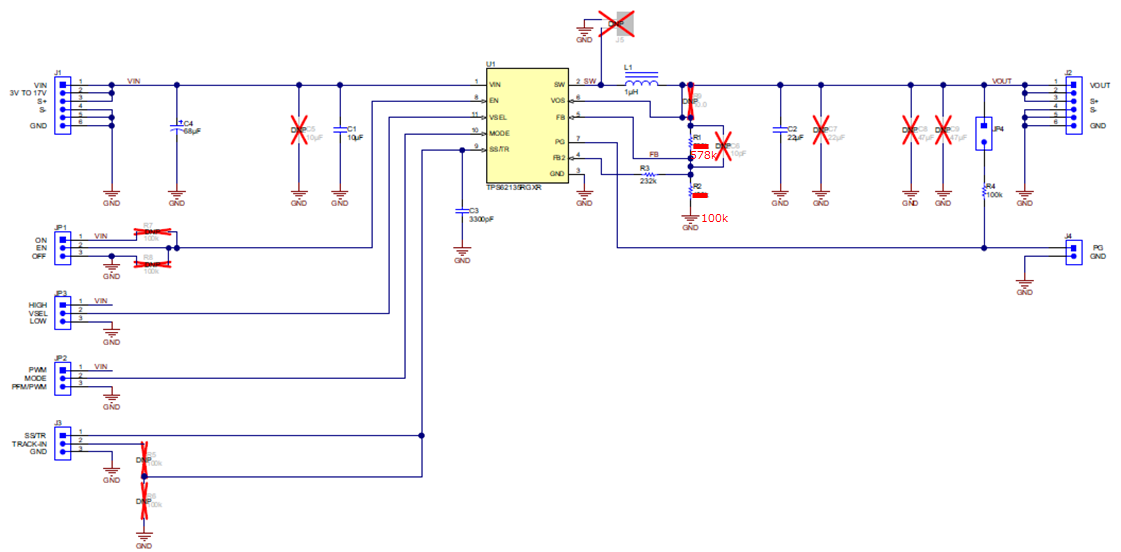

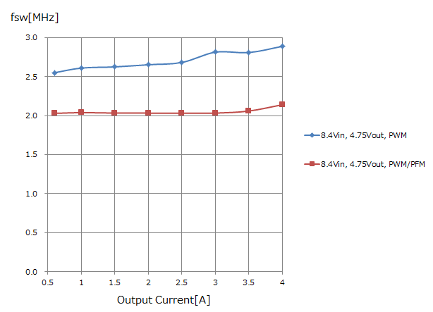

We got a question from the customer about TPS62135.
Could you help us?
[Question]
They measured the switching frequency in PWM(Mode pin is high) and PWM/PFM mode(Mode pin is low). Please refer to below plot. As you can see the switching frequency is different between these mode. Why is this occured?
