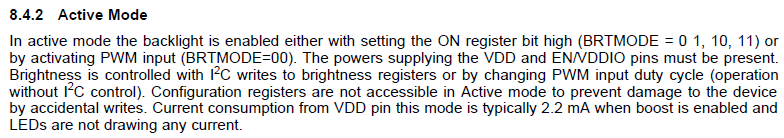

Hi Team,
I believe EPROM registers (98h, 9Eh, A0h-AFh) can be written only when backlight is disabled.
Is my understanding correct?
If the answer is yes, should I set both BL_CTL(01h, bit 0)=0 and BL_ON(A2h, bit 3)=0 before writing EPROM registers?
