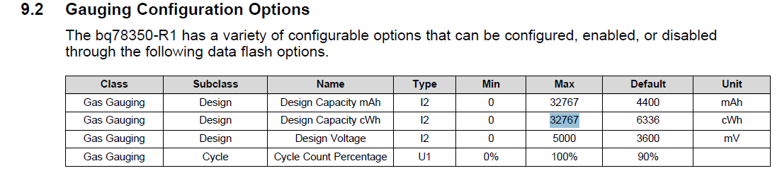

Dear All:
Our customer needs 7S6P  battery pack .
Design Capacity mAh: 2600mAh*6 = 15600mAh
Design Capacity cWh:  ???
Design Voltage :  3600  mV
I calculate the formula for Design Capacity cWh as follows: (2.6Ah*6P) * (3.6V*7S) *100 = 39312cWh
However, the maximum set value of the Design Capacity cWh in the data manual is 32767,   32767 <  39312
I can't write 39312cWh?
The figure below is a screenshot of the data manual and bqStudio configuration :
