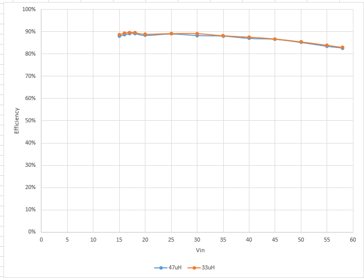

We have calculated LMR16006Y at the following condition with Webench Designer.
(Condition:Vmin:20V; Vmax:60V; Vout:15V; Iout=0.5A)
According to Webench Designer inductor should be 39uH. But we have tried 33uH and 47uH instead of 39uH.
We have measured average values of efficiency for both 33uH and 47uH are %88.
Our question:
Are we allowed to use 33uH and 47uH (Our trial and error) instead of 39uH (Webench Designer's calculated)?
