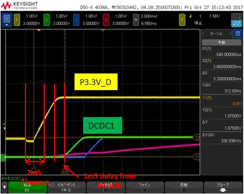

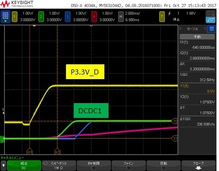

Our customer is using TPS65218.
It seems that the time from the start of P3.3 V_D (DCDC4) to the start of DCDC1 is about 4ms
The specification of the following document is written as 2ms.
8 Power-Up and Power-Down Sequence for TPS65218
www.tij.co.jp/.../slvuaa9a.pdf
Is this start timing correct?
For details, refer to the waveform below.

  • Shigehiro,
    I think we figured out what is happening here. Since it is taking longer than 2ms for your rail to reach its PGOOD level the device is instead waiting for the previous rail's PGOOD level to be met. Due to de-glitching the next rail can also have a 1mS delay between when PGOOD is met and the next rail powers up.
    Thank you,
    Nick
